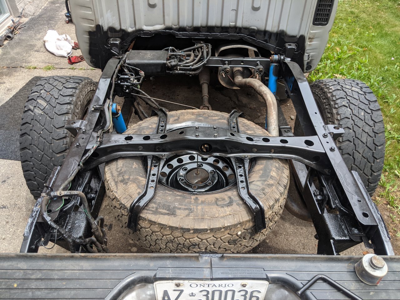

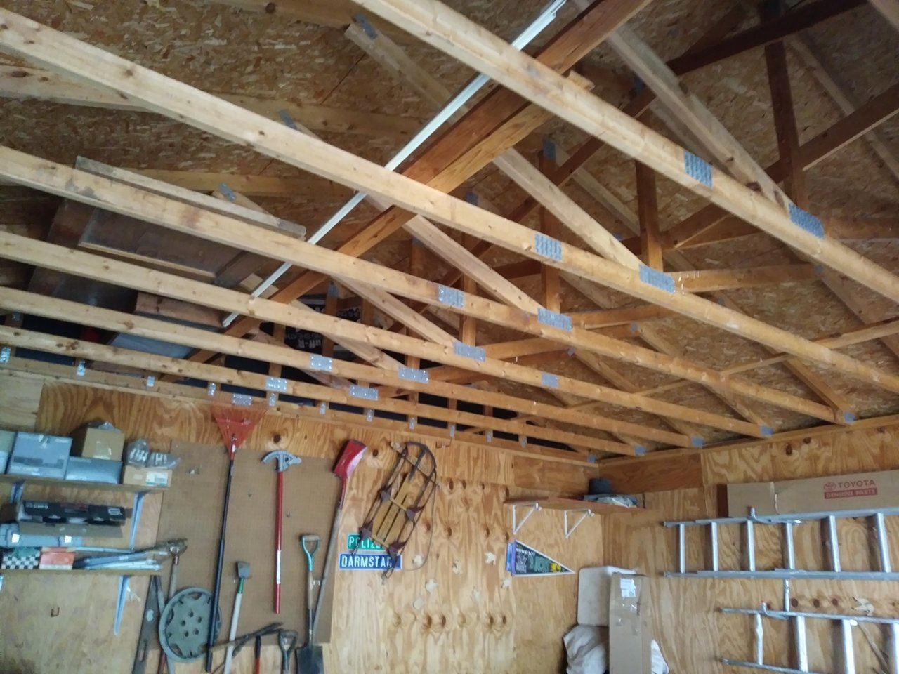

    I put a heavy steel bar between two joists, then used a block and tackle and some ratchet straps. Made it pretty easy.

    it looks like you are trusting those dreaded rope hooks to do the job!

    My garage

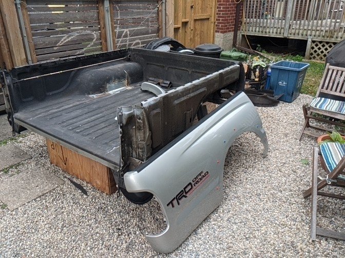

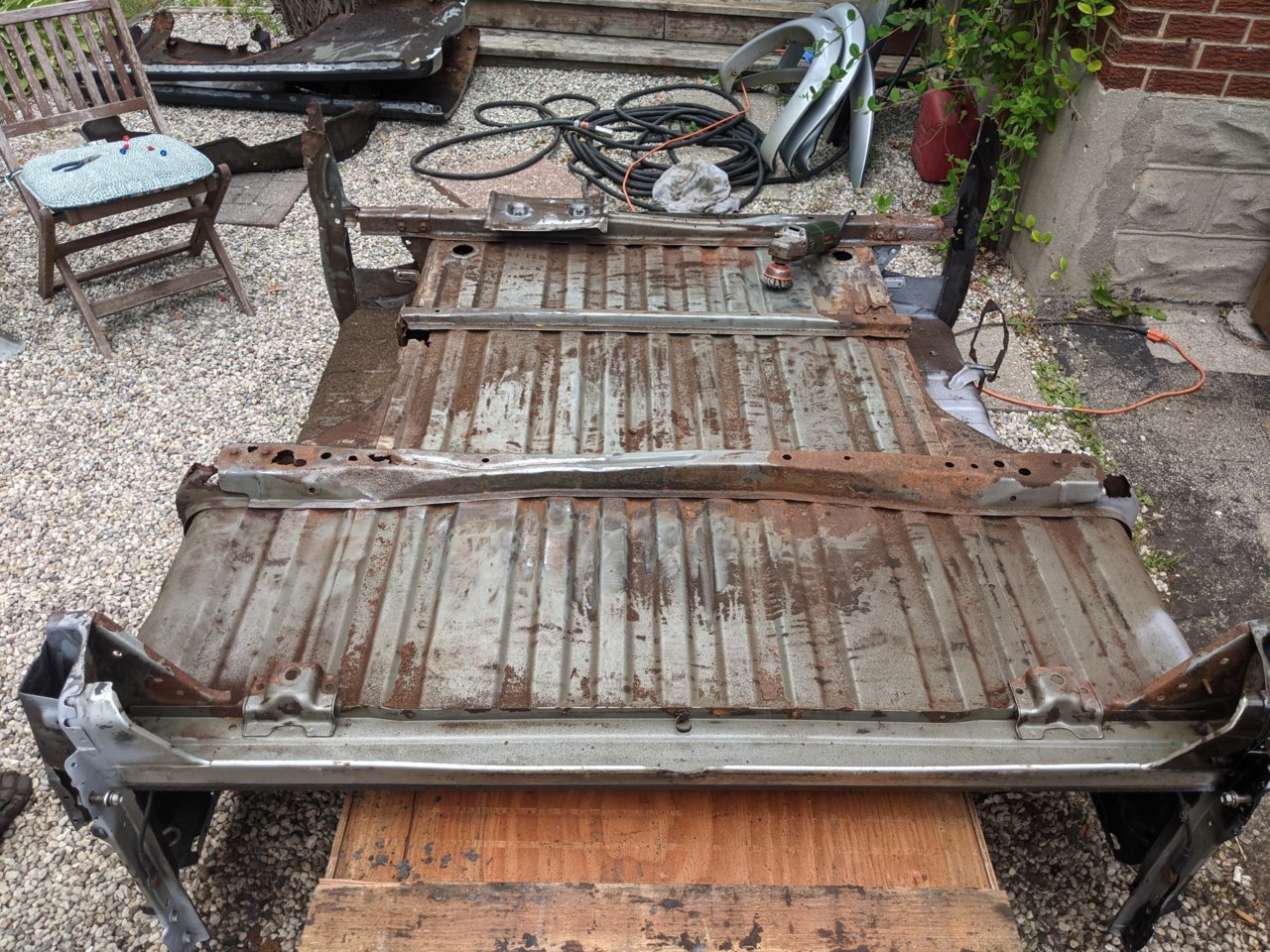

    I just did mine last summer, I don’t think it weighs more than a couple hindered pounds if that. Myself and my neighbour (average guys) lifted it off with no problem. Just watch out for the bumper if you don’t remove it as it can scratch the bed pretty easily. I covered mine with some towels.
    replaced the fender skins and blasted the rust on the bed and surface rust on the new frame. Then I painted and bedlinered the underside of the bed. Good as new!

    I did it myself, a buddy would have been useful. I don’t really have any other pics, there wasn’t a whole lot to it though. Just had to take my time and make sure I had enough free rope that I could tie it off, move something around, then keep going.
