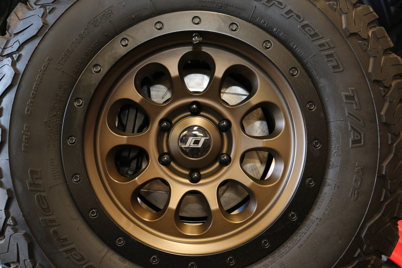

    Performed the 2010+ 4Runner 14WA 338mm brake swap this weekend. Write up coming soon Low Range Off-Road . Overall it was a success. I'll keep you posted Brycen. :burnrubber::drunk::bananadance::bananadance::bananadance:

    Sure thing. Overall pedal feel is great, has more bite than before and initial tests were great. I plan to do one more break test in about a week after they are a bit seasoned. We performed the brake test minutes after initial bedding.
    Took pictures from start to finish and videos of 40mph panic stop before and after. Hope to have a pretty conclusive write up. But i can say overall I like the overall feel much better.
    Setup is 14WA Caliper, Stoptech slotted Rotor, Stainless lines F/R with stock pads (debated on a semi or ceramic but good to test even on regular. Shows it will have more to improve on) and I used ATE Origional TYP 200 Dot 4 Brake Fluid (essentially super blue without the blue dye). Hope to have the write up in a weeks time after I can get another test run and compile the
    data.
    Here is a little teaser for you.... :transformer::benchpress: Looks killer no matter what. Especially hidden behind SCSPerformance Ray10's.

    I have the exact same wheels waiting to be installed as well. Im hunting 14WA calipers as we speak, going to start piecing it all together
