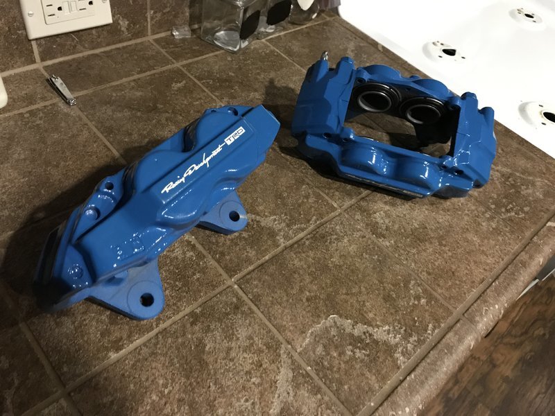

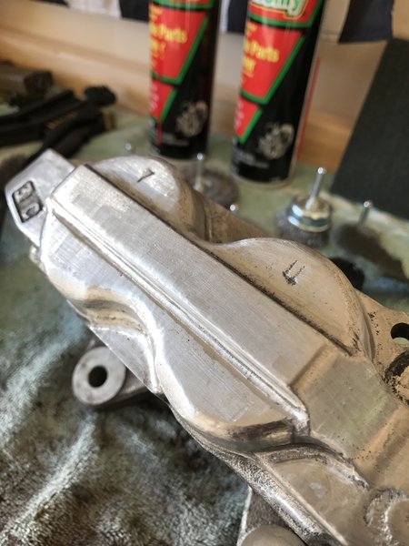

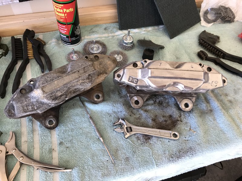

    @nudavinci64 what rotors did you go with? While I'm waiting on dust shields (where to buy, besides rock auto) and saving money for my new wheel bearings/hub assemblies off TW, I figured I could start doing up some 14WA calipers all nice.
    I have new KING suspension to put on along with blue SS brake lines. I got each caliper off eBay from a 2014 SR5 4Runner for $55 shipped each. Rebuild kit was around $8 each. Currently looking for the hardware kit and a bleeder screw One was bent badly and luckily I had some screw extractors because Oreillys wanted $85 for a single caliper (reman of course) plus $52 core, which technically I had I guess but they weren't in stock.
    Anyway I wore wheeled off as much of the brake dust and crap off of them and started to smooth the outside up. I don't have an air compressor here but my buddy does, so once I get both smoothed up and as clean as I can get them I will hopefully be able to blow the pistons out. I read on T4R that sometimes some of the pistons get stuck in these calipers :(, but I'm hopeful.
    Anywhere, here are a few pics. Thought about doing blue with white stickers but I think I'm gonna just do black with white stickers
    #46
    KeezfB and steveh_2007 like this.

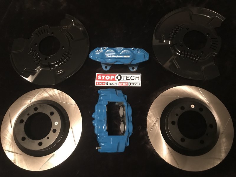

    @Low Range Off-Road sourced everything for me as this was a test fit for a possible offering on their site. The Rotors are Stoptech slotted rotors. Dust shields I believe were from Toyota. Probably one of the pricier items considering all the parts. You def need to replace those, the rotors would not fit at all with the stock ones. Re-manufactured is just find for the Calipers. Pretty sure that is what I got.
    Shouldn't be an issue if you get some Co2 through the pistons. I actually did that on mine as I removed the dust shields at one point while prepping and wanted to make sure they were set correctly.

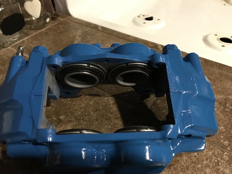

    Just finished the calipers. Ordered the StopTech slotted rotors tonight on eBay as well. $98 each free shipping. After that I found them on RockAuto for around $188 shipped for the pair. So a little cheaper, but oh well.
    Did you go with OEM pads or StopTech? I'm thinking I may try the EBC Green Stuff pads

    @arwinnnsd the calipers are stamped 14WA, I believe some of the pictures I posted of the calipers show this stamping on the side.
    Well looking back none do actually. But if you look at the last caliper in the OP you can see the stamping that I am talking about
