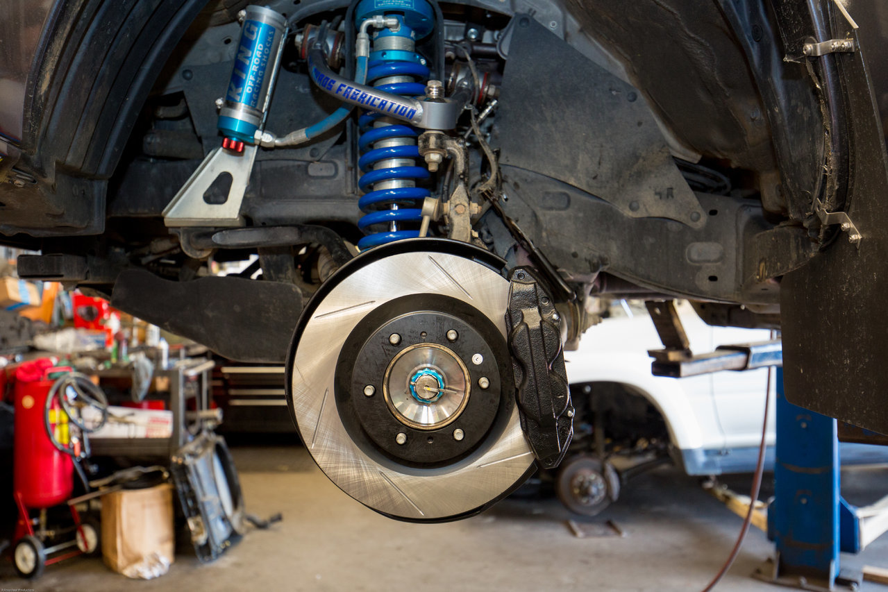

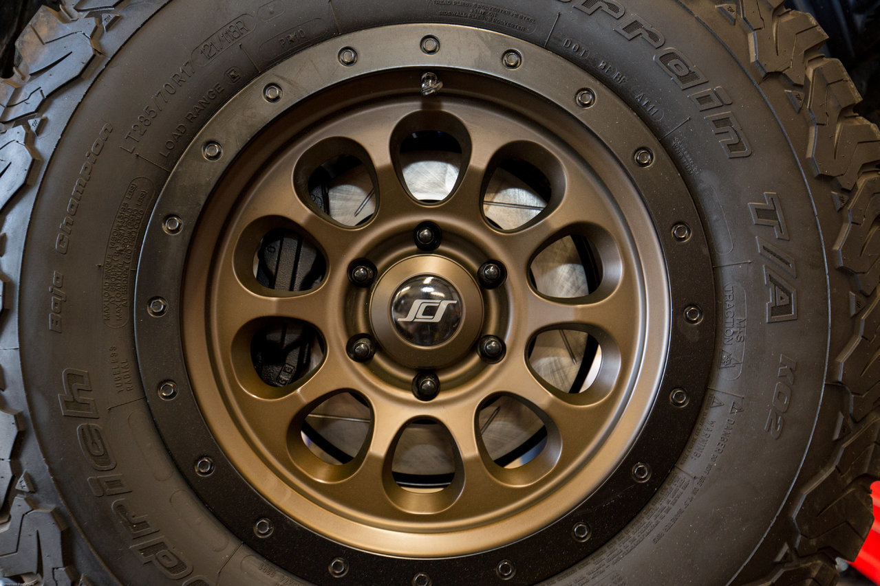

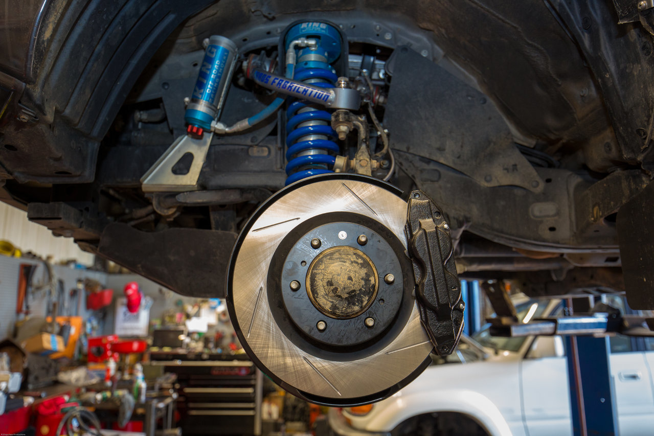

    A bit overdue but just typed up my review/experience with the 4th Gen 4 runner swap that I test fit for @Low Range Off-Road. Check it out.
    Nice upgrade for about 8-10% improvement with stock pads and affordable for everyone as it is only a bit more than replacing your stock rotors and pads, including stainless lines.
    4th Gen 4 Runner Brake Swap on 2nd Gen Tacoma
    SHOPSHEAR_2017_04_23_9999_111.jpg SHOPSHEAR_2017_04_23_9999_131.jpg SHOPSHEAR_2017_04_23_9999_172.jpg

    Don't bother buying them new. Buy a remanufactured (refurb unit). Old Caliper with all new parts for the most part. Centric makes some of the better ones. Any place like autozone, Oreillyes, napa etc have them. Centric though tends to have the better ones. I used Centric in my setup. If you go with new you mind as well look a full Stoptech BBK.
    Just make sure it is the 14WA stamping. The Lexus version of the similar year you may see has a differnt bolt batter for attatching to the hub etc.

    The 2016+ 4runners have 14wb calipers which have different size mounting bolts.

    Yah so 2010-2014 would be the safe bet. These are 14WA stamp.
