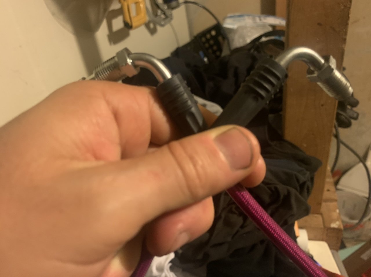

    Did you have to use a hard line connection with these calipers or just use a drilled out / short banjo bolt?

    Clearly I didn't respond, sorry.
    I have (lowrange?) Extended SS lines, and these didn't require any modifications.

    I got some male end hard line fitting ss lines to play it safe. My old banjo bolt lines actually did work.
