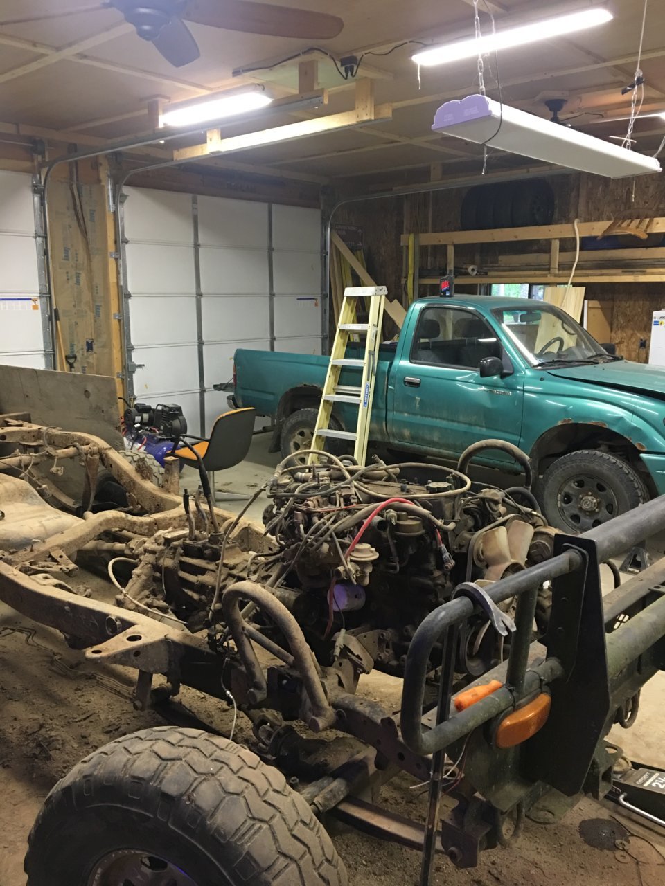

    B155F775-7EB5-4327-8E55-4D6F93F81EAD.jpg Good Morning all. Currently rebuilding my 87 SAS pickup. Motor was shot. Cab is shot. Frame down perfect.
    My old Daily drive was a 98 Taco with 2.7 the plan is a motor and cab swap onto the straight axel frame.
    Debating what to do with the gas tank. Probably be easiest to do a fuel cell in the box.
    So my questions are. Has anyone done an in-line fuel pump. Which pump did you use. And what PSI/flow rates are needed to support the 3rz

    Why can't you use the 3RZ tank? I would think re-routing the exhaust to the passenger side would be an easier job.

    I could it is a good tank. But fitting in the other frame would be some work having to fab the cross members. If it would even fit.
    Easiest thing to do is a cell in the box with an inline pump
