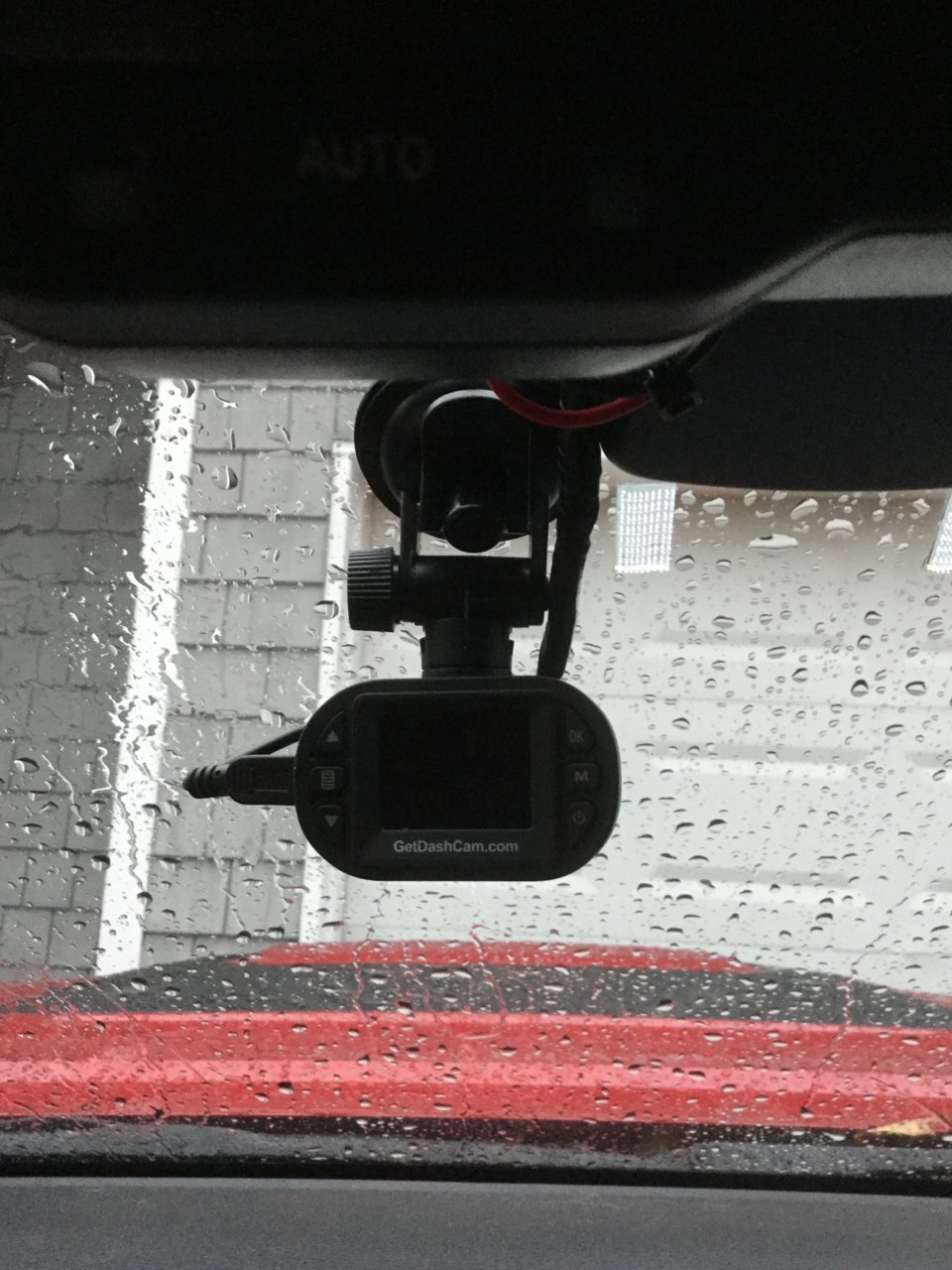

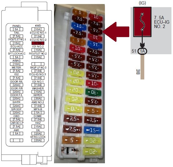

    Today I wired my dashboard camera to the power supply behind the mirror. I got information from Tacoma world on a separate listing. The beige wire is positive and the white w/ black wire is negative. I also ordered a step down for the power supply from 12 v ( by mirror ) to 5 v to the camera.
    Everything went perfect and the camera automatically comes on recording when the Tacoma is started. I cleaned all the tools to be put away and played with my perfect installation.
    I grabbed my key fob to lock the doors and NOTHING, what the............. The Key fob will not lock the doors. It’s dead. I tried the interior lock / unlock it works from inside but nothing from key fob. Fuse? Help

    Mine does the same thing when I installed my dash cam and wired it to the truck with a ad a fuse. I have to be standing directly next to the truck just for it to unlock, that's after hitting the unlock button many times. When I turn the camera off, it locks/unlocks perfectly. I have been wondering if anyone else had this problem but you beat me to posting.

    I've had bad Add-A-Fuses. Did you try removing that and reinstalling the original fuse?

    I had a similar problem with my dash cam. When my rear dash cam is powered in parking mode, the keyfob would work intermittently or not at all. When i unplug the rear cam, keyfob works as it should. Having the front dash cam plugged in by itself, i didnt run into any issues. Could be electromagnetic interference. Try removing power to the dash cam first before taking it to the dealer because if they find that is your problem, they will charge you for the troubleshooting.
