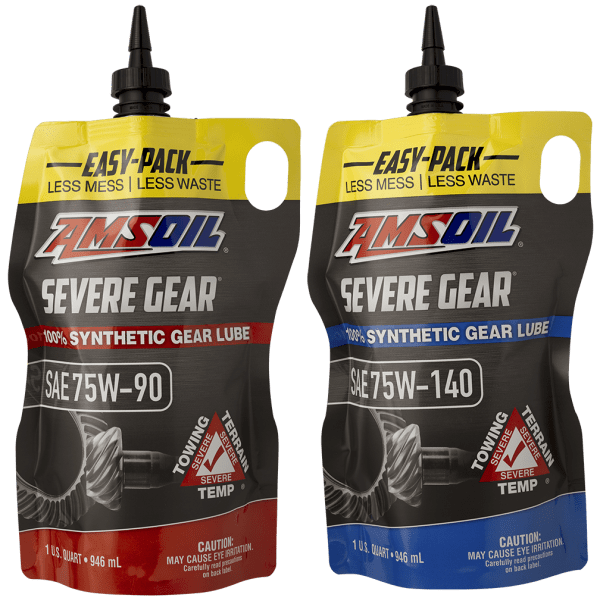

    Regardless of what brand you use...make it easy on yourself and get the squeeze pouch
