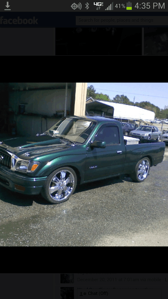

    I made the hood and fit lexus emblems in the grill glassed the door panel inserts and center dash vents installed 3 gauges there. Custom interior I did everything by myself I have 2 trophys for it but every show around his is muscle cars and a lot people don't realize the detail I have in it there are no chipped up bolts body is straight color sanded it for 4hrs n 2 days worth of buffing it was perfect when I finished it but then I bought my house n it got scratched and beat up moving it. I'm still going to cut the bed jack it out weld it n straighten it to tuck the mt's how I want them . And that is a 30 spline 79 toyota axle with 4.10s n limited slip and disc brakes its also 4in shorter than stock.

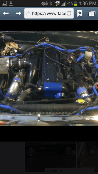

    Ok so I think I'm going to pull the trigger on the 200LB 9in coils with air shocks or progressive bump stops. I also have my fuel cell located where the spare tire use to be (12gal)
    Just a list of parts on the truck
    Ported 1jz vvti head
    2jz ge block (because it was free and the oil squirters become a problem after 700hp)
    Custom motor mounts
    Weisco 40 over pistons forged
    Manley h beam rods forged
    Sard fuel rail and 1000cc injectors
    6an fuel lines
    Progressive fuel regulator
    Wide band o2
    Atf billet fly wheel, starter shim and trans adapter for gm
    Th400 trans
    Custom header
    Djm 3in front 4in rear drop
    20s plus 28/10.5/15 on 12in aluminum rims
    Custom paint and hood and interior
    4wheel disc brakes
    Limited slip (acts more like a spool)
    Black head lights and tails
    2ladder bars
    100shot
    System
    Arp head and rod studs
    Future upgrades
    Pt7675bb cea turbo at 30-40 psi on 110
    Cage
    Trans brake and 4000 stall
    Vacuum pump
    High flow oil pump
    Arp main studs
    Flare the bedsides
    Maybe cadi tails
    My springs
    Maybe a monitor where factory gauges go for digital look and tunning
    Dual 044 fuel pumps
    Billet main caps
    And maybe an q45 tb and custom intake
