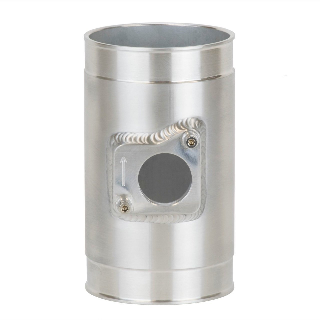

    I think you guys are over-thinking the MAF situation.
    You use the same MAF. You use a larger diameter MAF housing (the tube the maf goes into). Lets say "stock" is 2.5 inch diameter. You go to 3.5 inch diameter.
    you then rescale the G/sec on the maf to voltage to match the new MAF tube size. As a result, the MAF can now read more air.

    So in other words, using something like the dual-vvti 4.0 intake tube (larger diameter) would make it possible.

    Something like this with a custom intake / filter tubing
    **note** important for me to say you cannot do this without tuning.

    Yes we are on the same page. The newer 1GR intake is a bigger tube, so it would be an easy fairly plug and play setup. Someone on this forum has installed one. I think they were throwing lean codes because of no tuning though.
