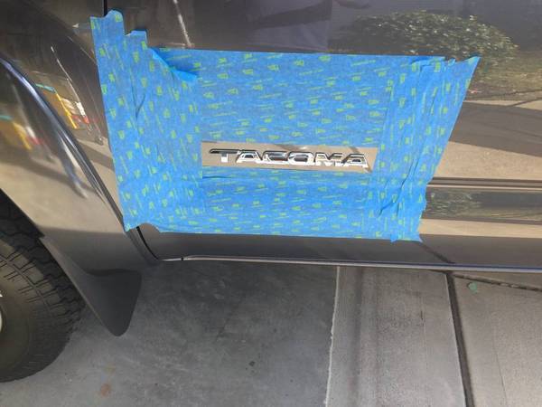

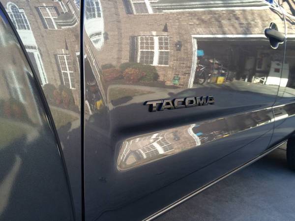

    Plasti dip them buggers. I didn't take mine off to do them, there is a thread for that too. Just picture frame it in blue tape and spray 'em right on the truck. Peel the dip off your paint slowly, and it will release at the badge. very light coat at first, then like 5-7 good coats after that. Wipe off any overspray with WD40, comes off no problemo
