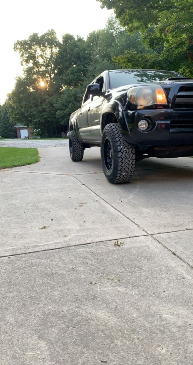

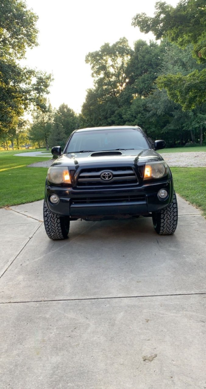

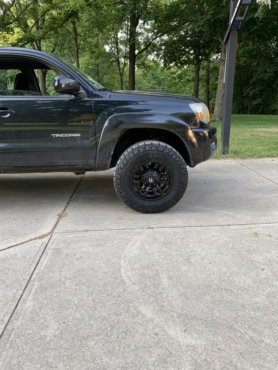

    Black tacoma 2009, 2.7 liter, extended cab, 4 wheel drive
    2 inch Leveling kit, 275/70/R17
    F8C52480-3CE4-4C93-83C9-C3A9AC630C82.jpg FBB80644-14D3-426F-941C-480885F0096B.jpgC3F89B42-5484-4733-9084-29F3786A601D.jpg
    275/70/R17 fit with a 2 inch leveling kit. Rubbed a bit but after a few minutes of trimming I was good to go. They ended up being 32s. It is a 2009 Tacoma.

    Looks sweet. What leveling kit did you go with?

    Are you using wheel spacers? or what offset are your rims because I like that look.

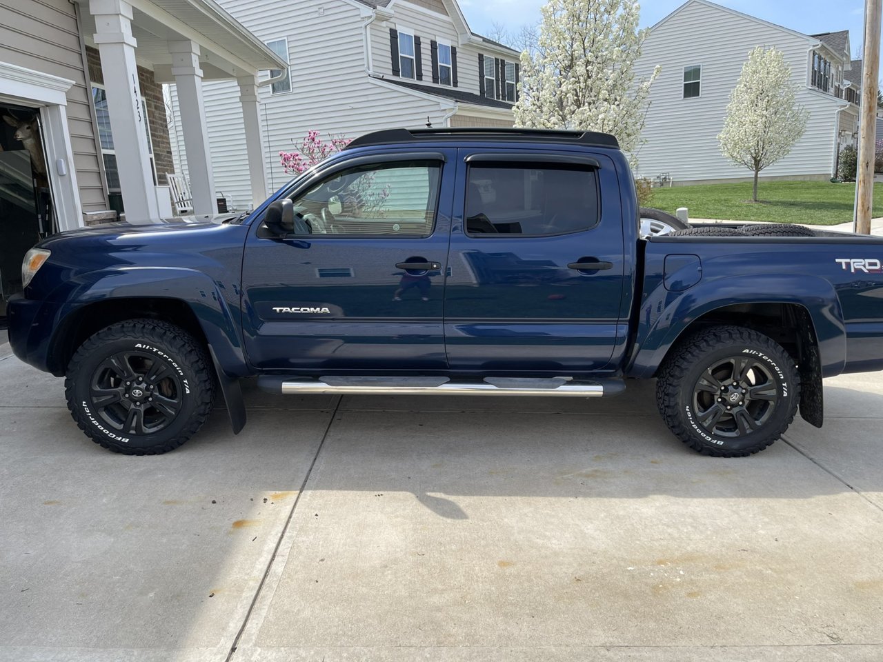

    245/65/17. 2007 prerunner with 2016 rims and KO2 tires

    It rode pretty well, a little bit bumpier but not horrible. Once I put the new tires on it got very rough so I am getting it realigned. And it is -12 offset with no spacers.
