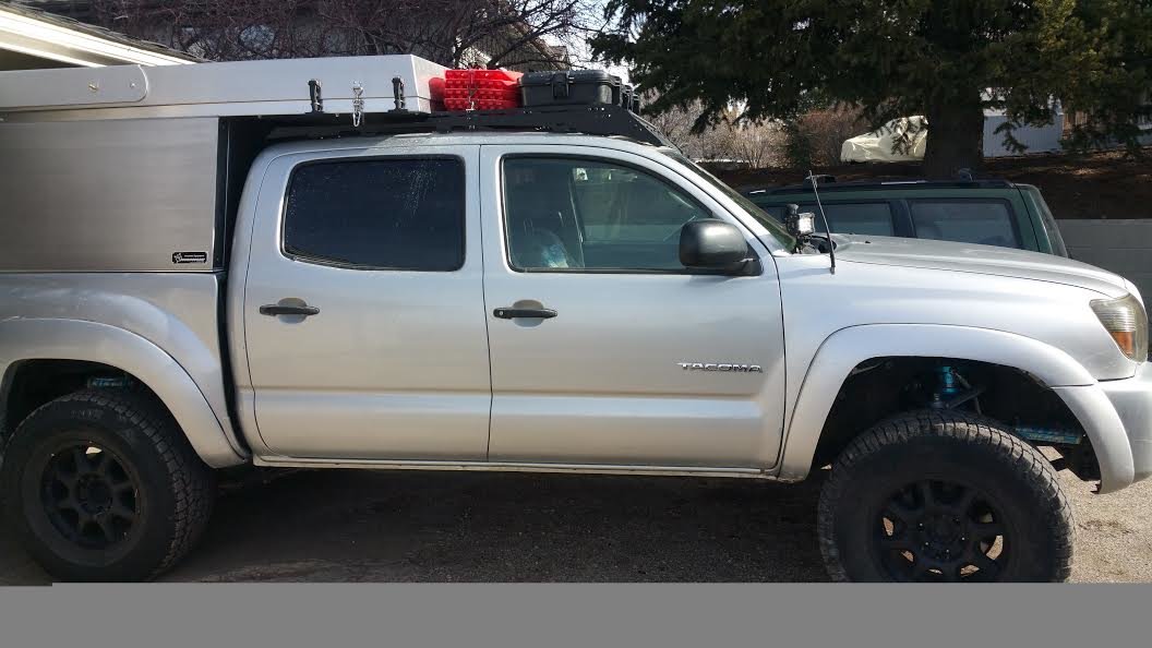

    Posting this here for @kai38` as he was asking for a picture of a cut down prinsu rack with habitat.
    I have only viewed this on my phone so hopefully it will be good enough to depict how I cut it, if not I will get more tomorrow.unnamed.jpg
    It would be easier to just cut it at the middle mount and end it there, but I thought it would look better to retain the rear mounts on the rack and just provide enough clearance for cab - frame flex

    Thanks for the picture!
    Looks great
    Is your Tacoma a long bed or short bed?
    The over hang of the Habitat is different.

    No problem, let me know if you need anything more specific.
    EDIT: Oh, and also Rustoleum textured black paint is a DEAD match for the prinsu black powdercoat for your cut, you literally cannot see where it is painted.

    shortbed

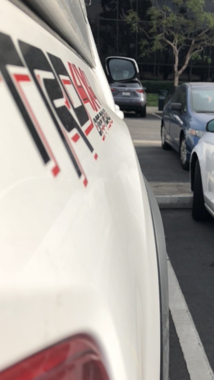

    Has anyone experienced and issue where the bed of the truck is out of alignment with the cab? I noticed my bed is about 0.5"ish offset to the drivers side...I'm wondering if this is a result of body/bed flex from wheeling with the habitat on giving the bed a higher center of gravity relative and movingnormal, or if the crooked bed is a general issue people have seen on 3rd gens...thanks

    Ahh ok, thanks for the info. I think we may be talking about separate issues, but I think the bed stiffener idea is a good one. Check out the pic below, more of my cab showing on the passenger side vs the driver.

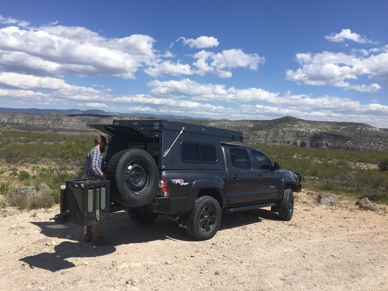

    My driver side did that as well. I have to put my new tent body on when the snow goes away, I have a pile of rivets to do....
    We use an assortment of harddig cases for our food and kitchen bins. When closed they form a staircase for the night... and make a decent bear box.
    Honestly, the worst thing is exiting at 2am to take a leak and dragging your back across the edge at the top of the rear opening!
    I have reinforcement brackets for my bed sides at the tail gate. I thought of the issue before we even left for Prescott. If nothing else, it's good for tying down gear and mine have built in bottle openers. Other gear is held down by aircraft tracking from northern tool. I take my belt sander and chamfer the corners so they fit perfectly in the dips of the bed bottom. This way I have a myriad of tie down locations to play with.
    Aside that, a 27gal water bladder resides in a plywood box at the front of the bed between and even with the wheel wells. And the fridge is in the passenger rear corner.
    We have one sleep platform making a three adult capacity. I am building a cedar panel for the remaining opening to keep the little ones from falling in.
    Any other questions ask away, just tag me so I can find it.

    That’s not good. The habitat is bolted into the sliding rail system in the inside of the bed as you know. Go back thru and tighten up the bolts that go into the bed rails see if that straightens out the issue. With my habitat it does overhang just a little bit on both sides but it’s equaled out.

    Since I am not seeing it first hand, the thing that jumps out at me is how the Habitat is mounted to the Tacoma's interior bed rails. If they are not square or level the clamps connecting the Habitat to the bed may be pulling it out of square, something to check.
