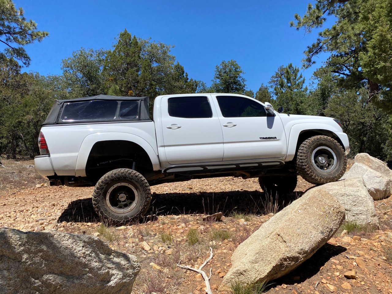

    Gentlemen, I’m copying and pasting the message I sent to Eric regarding what a difference it made going from the OME Dakar EL095R springs to the Deaver U402 stage 2 packs. The difference is night and day after adjusting the compression tubes. No shudder on acceleration/deceleration and the handling over bumps and overall is miles improved!
    What surprised me the most is when installing the Deavers, I had to take a ratchet strap to the cross tube and the axle and pull the entire axle housing back approximately 1” so the center bolts in the leafs would line up with the holes. I know that deaver springs are on the longer side, but they also specifically designed the U402 for the Tacoma. I just wanted to share my experience, and note that switching to the longer spring/shorter shackled significantly improved geometry over that of the dakars.

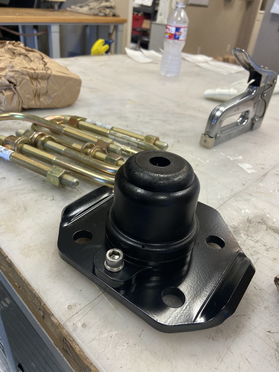

    Fab'd spindle goodness right there. I'm saving for a 3.5+ right now to run these with. :cheers:
