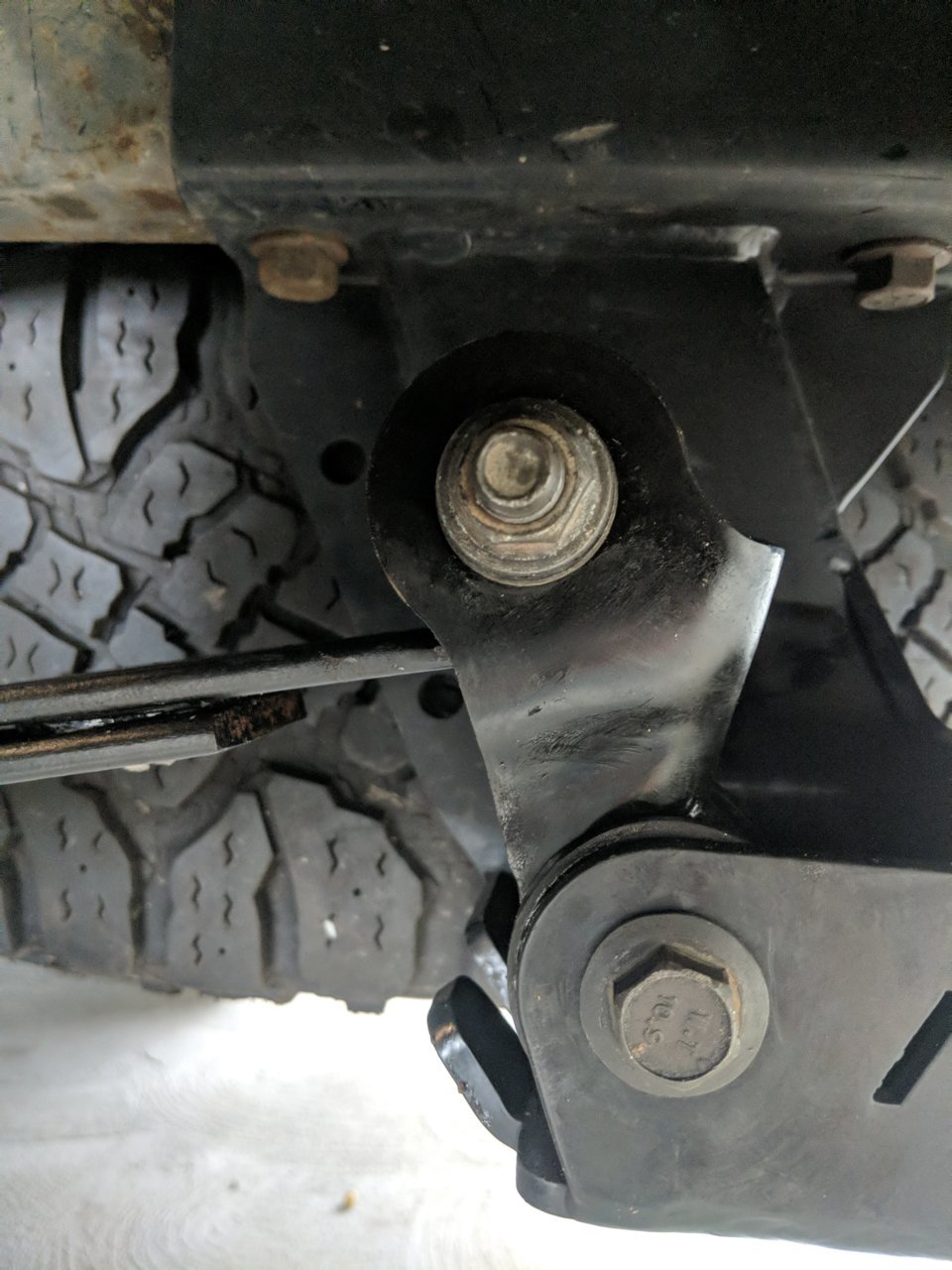

    Why in the hell I was toughing out my Frankenstein all pro leaf springs I will never know....
    These dobinsons are awesome. They literally drop the shackles out flat
