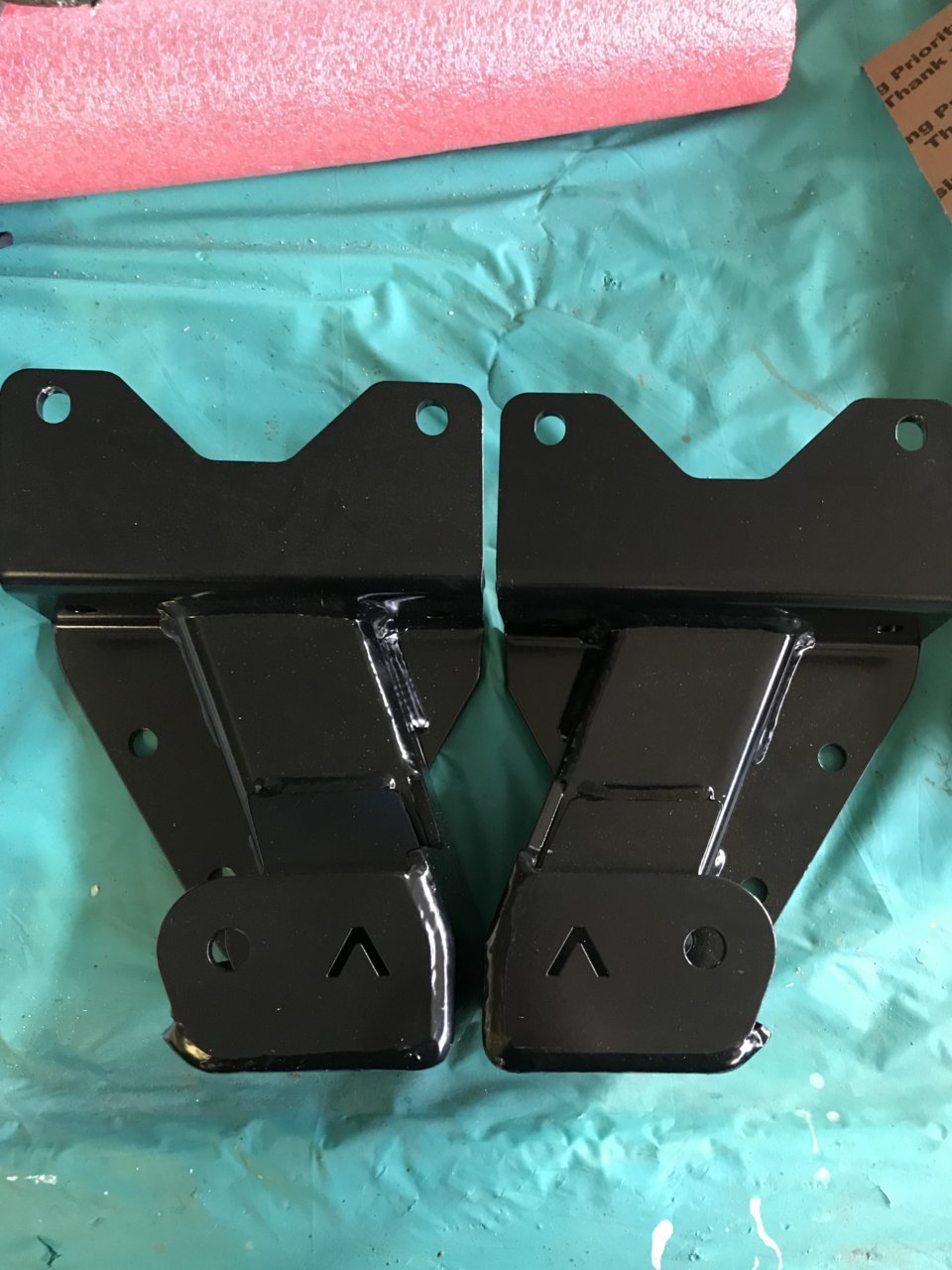

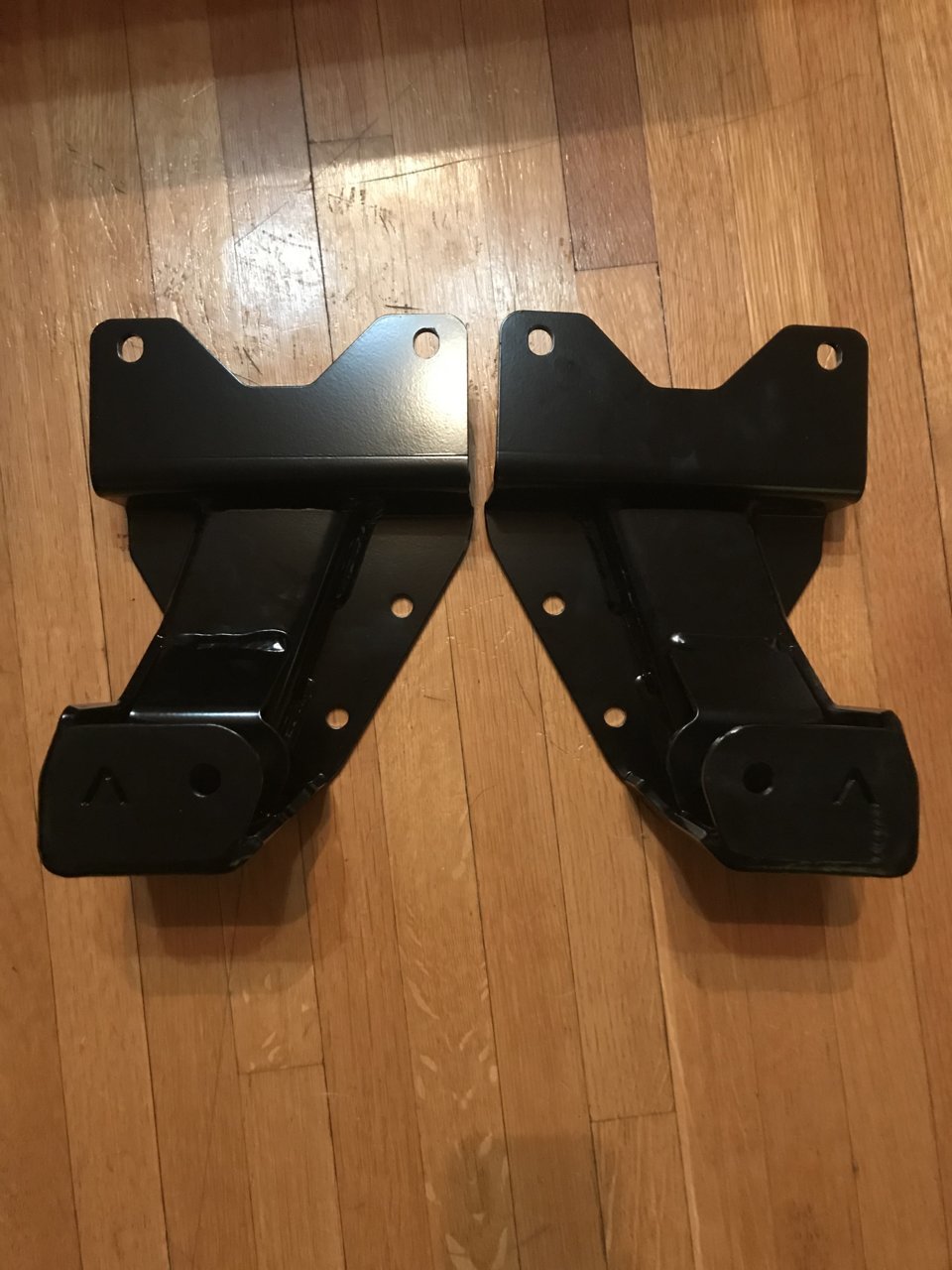

    I can always appreciate great design that rewards the driver. The hangers look like something mod mafia makes for hummers. Very heavy duty.
