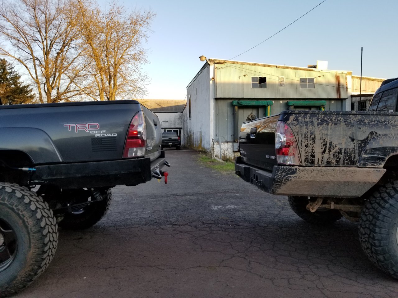

    OK....Looking for 2-1/2" lift from stock....Able to hold 250 to 400lbs more than stock leaf pack. (but can deal with MORE capacity) 2011 DCSB. Which one is closest to what I need, and what else would I need to make that work?
    Blackout14[OP] and TacoTRD78 like this.
  11. May 30, 2018 at 6:25 AM
    #191
    Blackout14
    Blackout14 [OP] Guest
    4+1 will get you that. you will end up with around 3 inches of lift. You will need a longer shock at least a ten inch stroke a cheaper option thats popular is the b110 shocks from billstien. extended break lines are reccomended because they will be tight at full droop but it you pull them off the bracket its not something that is dire right away.

    How much lift would the 4+1 provide at no additional weight?

    I have the 4+1, but paired with a shackle flip and the only weight is the high clearance bumper. I'm on the left. The other truck has deavers. I'd say I'm a good 3" over stock. If I remember correctly, I measured 27" from hub center to edge of fender. I can measure again when I get to a tape measure.

    Mark beat me to it. Subract an inch for his shackle flip than add it back on for his rear bumper if you arent running one so like he said right around 3 inches over stock
