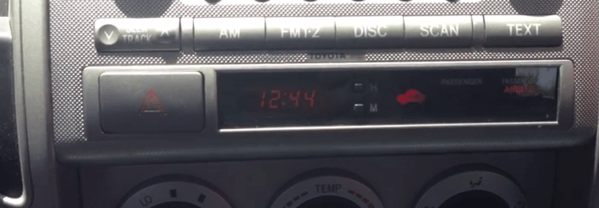

    ^ this. Also it would be helpful if you could tell us what your immobilizer light is doing, it should blink with the key out of the ignition. [​IMG]
    Edit: the immobilizer light is the red car/light with the key in it.
