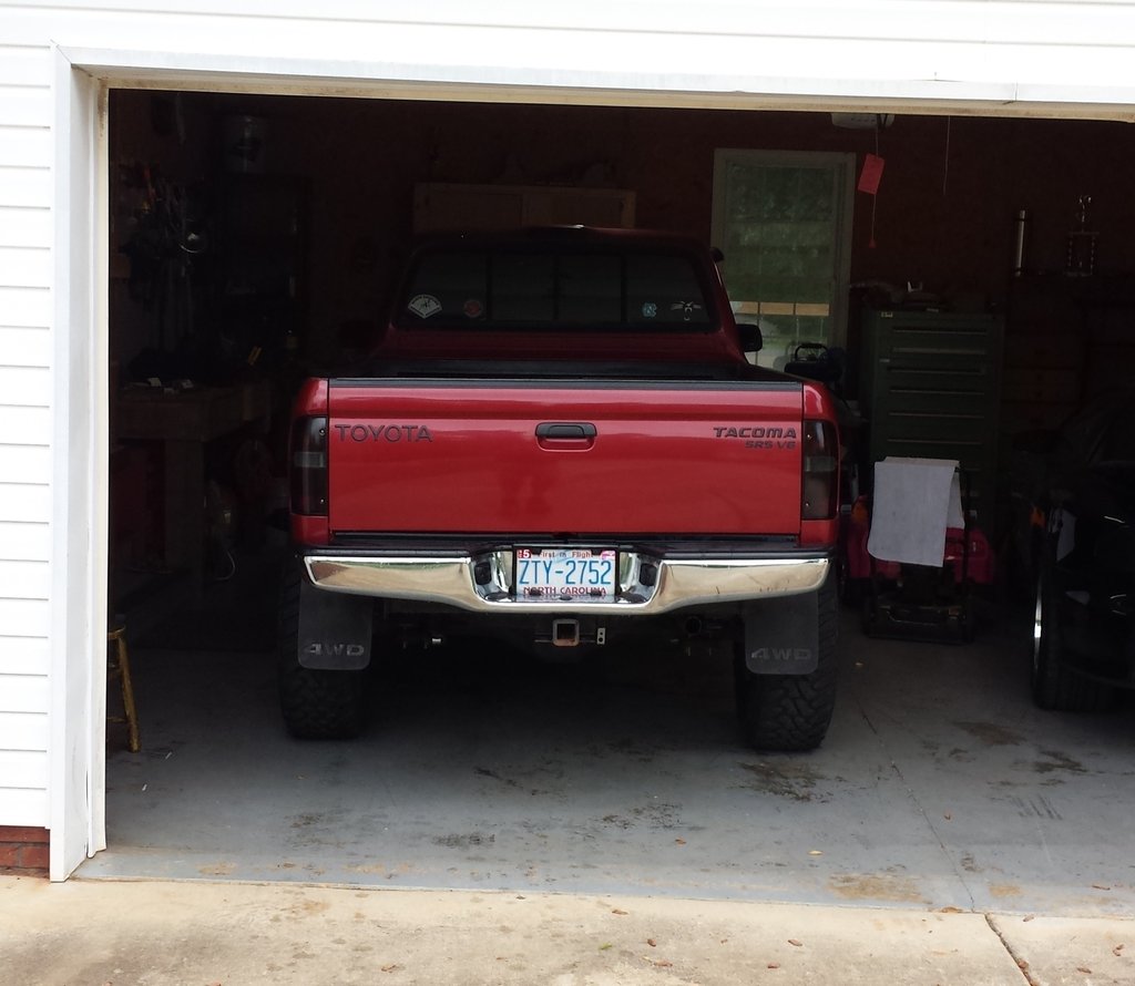

    I just installed my Toytec Boss Suspension System(with Diff. drop) with Total Chaos UCA's, and with Complete OME Dakar leaf springs on my 98' Taco, 3.4L, with 33" Toyo OC M/T's. It had a lean before, and leans more now. (Yes I have researched the site...and the web, see below. lol.)
    Rear Before:
    Driver side-35"
    Pass. side-35.5"
    Rear After:
    Driver side-40.5"
    Pass. side-41.5"
    Sorry, no “Before” front measurements
    Front After:
    DS-39 1/4"
    PS-40 1/4:”
    (These measurements are from a level floor to bottom center of fenders with a measuring tape. They were “eyeballed” due to 1.5” wheel spacers. Yes I know I should've measured from a different spot...I can't go back and re-measure. ha ha.)
    I saw this in another post: (My Dakar kit did not have this. It had a + on each spring.)
    "For example, OME Dakar leaf packs are marked with a + or - to let you know if they are slightly stiffer than spec (+) or slightly under spec (-). You generally get one of each when you order them, so the stiffer pack is designed to go on the drivers side to support the additional weight on that side of the truck."
    08f679e3-a274-42cc-9a21-f48c041229e7_zps_8ea4ae5a4f6cbae46ec175e8479d9527511a90d8.jpg
    Front:
    So I have adjustable Coilovers in the front that are not any way near maxed out. Should I just adjust them up enough to level it out? It makes sense to me. I don't want to completely kill the nice ride it has now. I also saw this on another thread:
    http://toyteclifts.3dcartstores.com/Front-Top-Plate-Spacer-One--14_p_351.html
    Thanks for any thoughts on this.
    Rear:
    So I'm thinking 1" spacer. Here is what I found from Toytec:
    http://toyteclifts.3dcartstores.com/12-Solid-Steel-Axle-Shim_p_1352.html
    Should I use 2 of these or find an actual 1" spacer somewhere else? I don't want to buy a "Set" of blocks when I only need one side elevated. What are my options? Thanks.

    I would lift the front driver side. You could bring passenger down a hair and driver up a hair

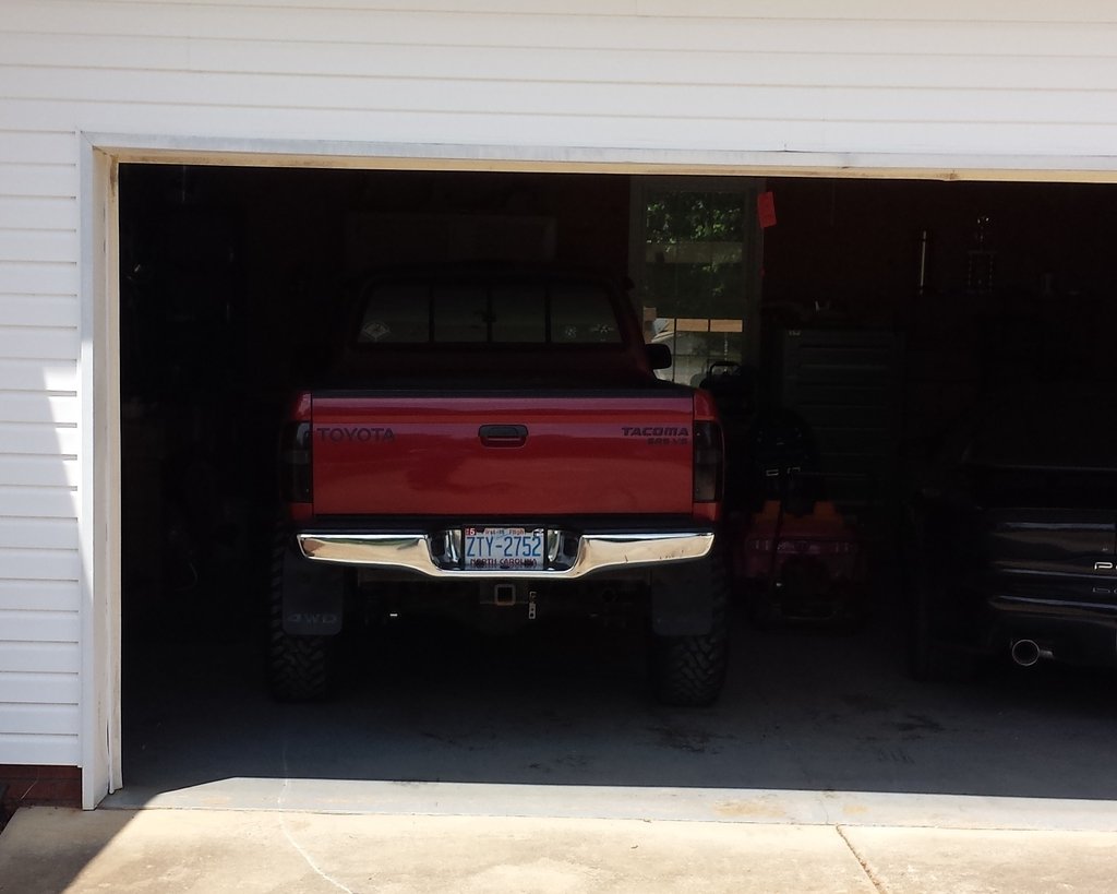

    Ok. So I got the swap done yesterday. Pics today.
    Before swap to put leafs on correct sides:
    After swap:
    13d798d6-8df7-40cc-aa21-3d987e283cc1_zps_6fe260710f8a9d300faaf25086b21994bddb3b6a.jpg
    So I'd call it a fail. Still not level. I guess 1" rear spacer it is. : (

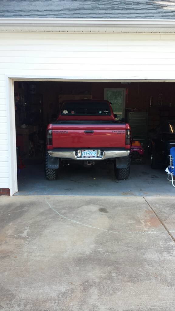

    So I adjusted the front left coilover. I brought it up an inch to match the right side. It fixed the driver side rub that occurred when backing left and steering wheel turned all the way left. I think it helped the lean too. (See pic). I don't know if I'm imagining it, but it may ride just a little firmer as you'd expect. Overall, think I'm happy with it.

    Guess my suggestion was right lol. I would have brought the passenger down .5" and driver up .5"
