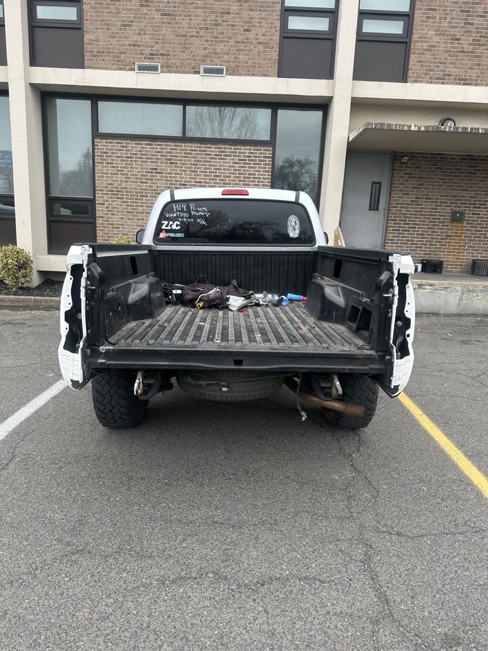

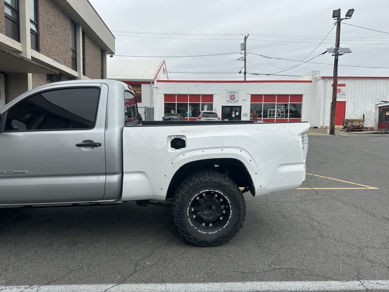

    Hey Taco people. So I’m doing the Single Cab Conversion and notice one the pass panel looks perfect but the driver one is a little lifted from the back kinda slanted or leaning. Is this the Taco lean? Or something else my OCD driving me crazy. The Driver panel on the pic needs the bottom bracket bolted on but it still looks the same

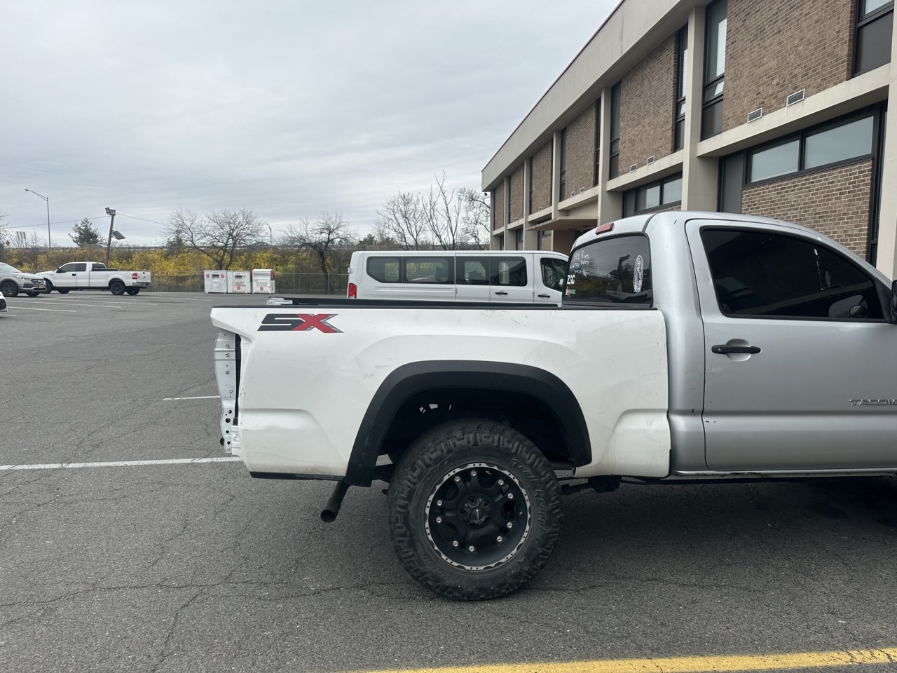

    In the 2nd picture, the bed looks “twisted”?
    The taco lean is usually the whole left (drivers) side is lower.

    I agree. The bed looks twisted to me. OP measure corner to corner and make sure your square.

    If there is a twist in the frame, it could cause the bed to be twisted. Measurements with the bed off. Was it hit?

    Got it. To me the bed looks twisted.
    Did you have that gap before doing the bedside swap? Any rear end accidents?
    The gap between the cab and bed side could be measured at top and bottom. In the pics it looks symmetrical on the passenger side. Driver side, it looks wide at the bottom and tight at the top.
