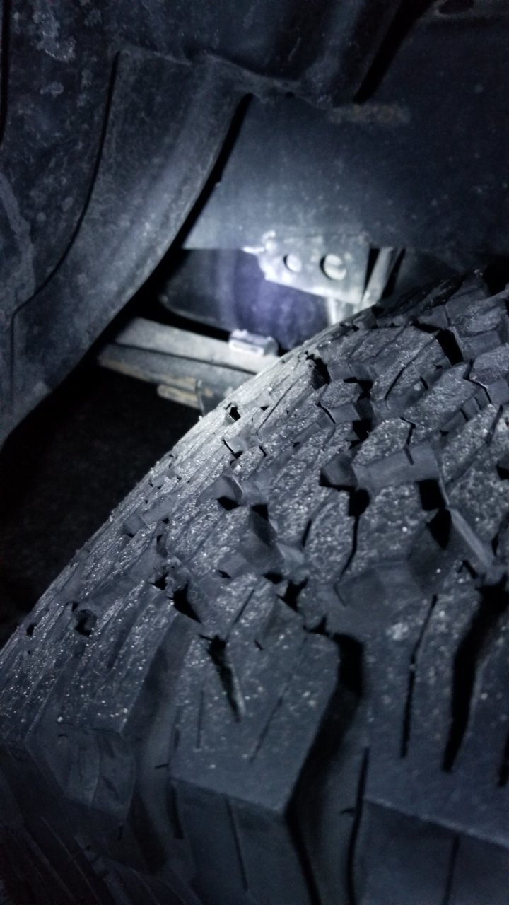

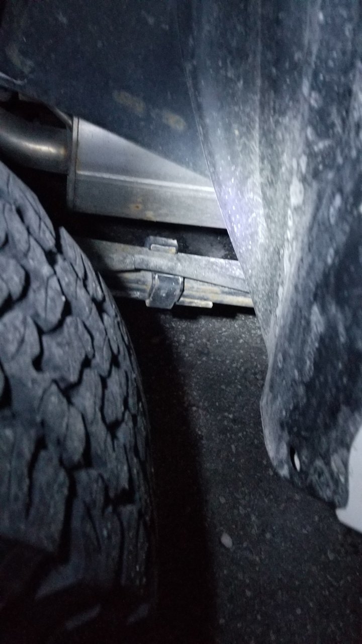

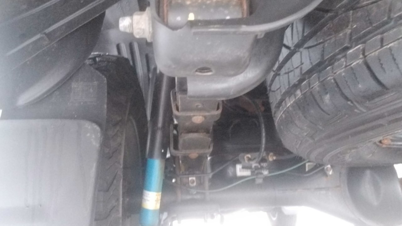

  12. Jan 9, 2021 at 5:05 PM
    #32
    Tehkoema
    Tehkoema [OP] Well-Known Member
    Jan 10, 2018
    #240887
    1,428
    Ottawa, ON
    2024 TRD Sport 6MT

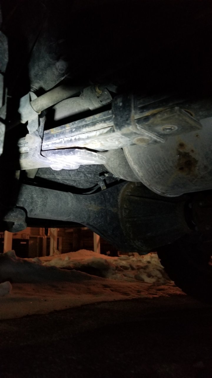

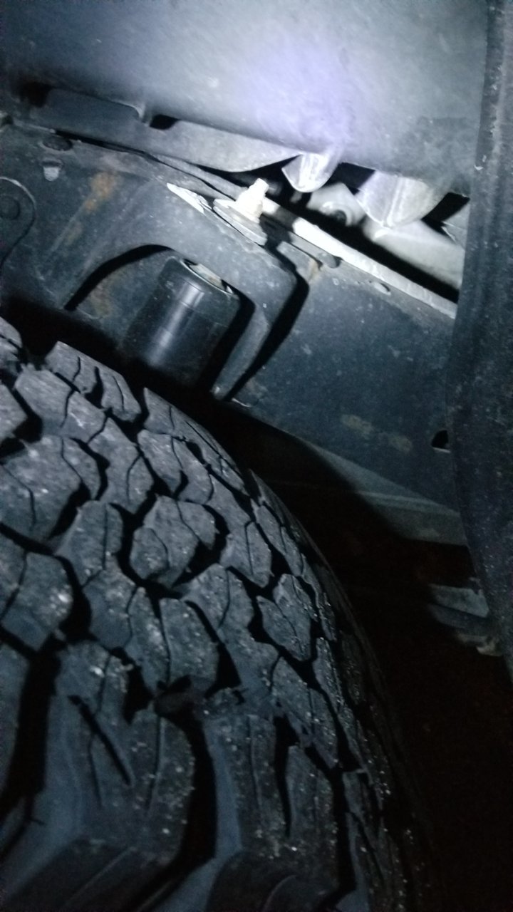

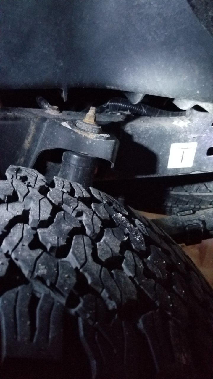

    some more pictures, i know the lighting socks but maybe more trained eyes can makes sense of anything off.
    driver's side;

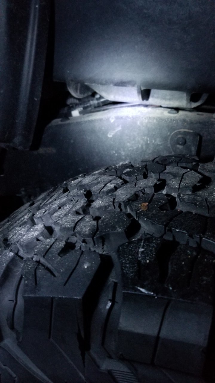

  13. Jan 9, 2021 at 5:06 PM
    #33
    Tehkoema
    Jan 10, 2018
    #240887
    1,428
    Ottawa, ON
    2024 TRD Sport 6MT
    passenger;
  14. Jan 9, 2021 at 6:54 PM
    #34
    Tehkoema
    Jan 10, 2018
    #240887
    1,428
    Ottawa, ON
    2024 TRD Sport 6MT
    I'm thinking I have Taco lean in conjunction with something else slightly out of spec which is exaggerating the lean. Idk if it's bad leafs, poor install (I have the squeaky leaf spring TSB done 1 or 2 years ago), my weight that may have worn down something on the driver's side, idk but at this point just want to get a cosmetic fix as it's driving me nuts.
    my question is would the usual 1/4 inch spacer up front do anything for the rear? There will still be a lean but I'm hoping if I address the Taco lean itself the other underlying issue will be hard to spot with the naked eye.
    also, is this spacer the one everyone uses? Also locked up this shim for the driver's leaf pack. I'm thinking combing these two should get me pretty close to level front to back.

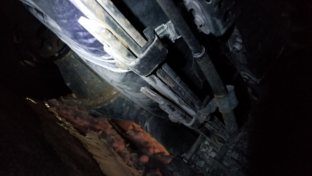

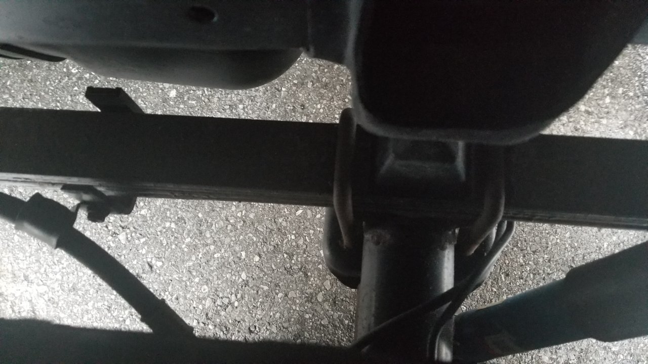

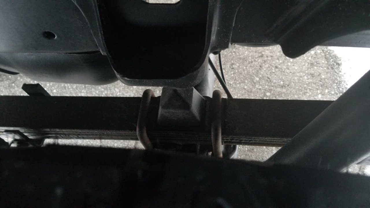

  15. Jan 10, 2021 at 1:30 PM
    #35
    Tehkoema
    Jan 10, 2018
    #240887
    1,428
    Ottawa, ON
    2024 TRD Sport 6MT

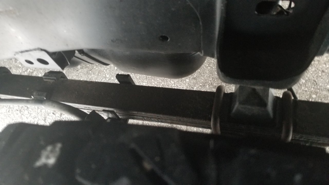

    more pictures of the drivers side leafs. is it just me or do they appear canted in the last picture along the same angle as the lean?

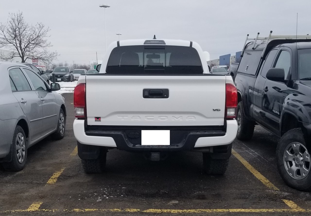

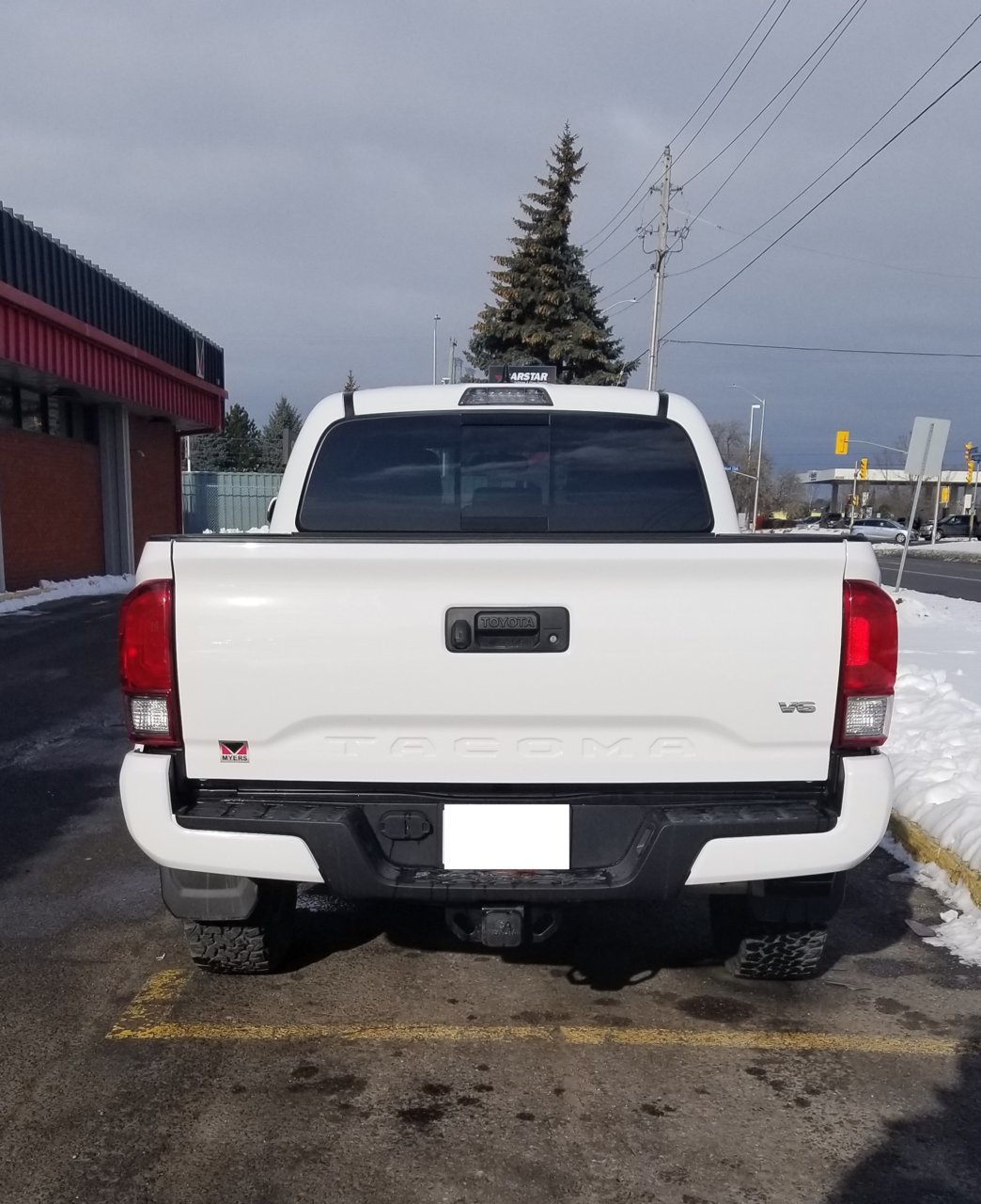

  18. Jan 11, 2021 at 9:16 AM
    #38
    Tehkoema
    Jan 10, 2018
    #240887
    1,428
    Ottawa, ON
    2024 TRD Sport 6MT

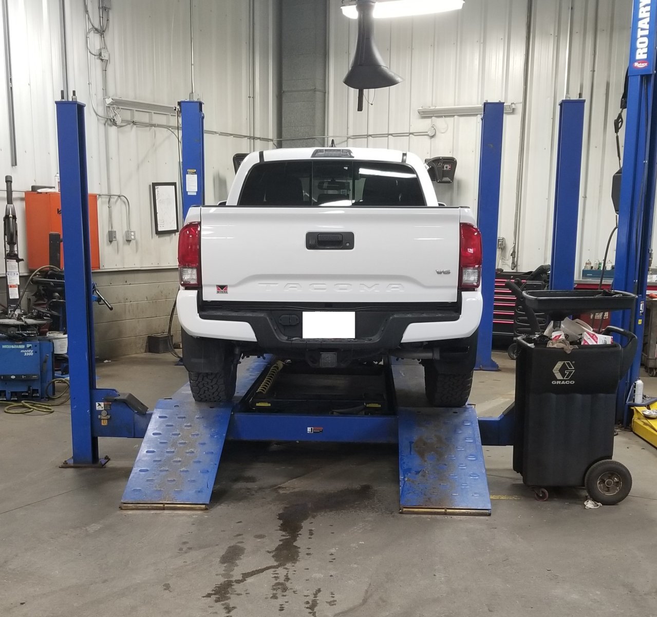

    Okay, major update time.
    So I took the truck to a different dealer this morning. These guys have a good reputation and I explained to them I felt my dealer was screwing with me. They put the truck on the alignment rack for precise measurements...and it was almost perfectly level. They brought me in and measured in front of me as well. Picture below.
    I couldn't believe it. I felt like I was losing my mind. They assured me the truck is well within spec and better than a lot of others they have seen.
    I checked the truck out afterwards and I don't know what they did to it but the lean is way better now. Still there but way less noticeable.
    Completely confused I then took it to a collision repair shop to get their weigh in. They looked at it in every direction and could not find a panel off or anything that would indicate frame issues. They did measure it in the lot and they found 1/2 inch lower on the driver's side front and back.
    No suspension issues, no body issues... I have to conclude that it's my fat ass causing the exaggerated lean that apparently the dealer has now somehow reset (?).
    I think a 1/4 spacer up front (and a diet) would sort this out but still confused how I was getting different measurements before this morning.
  19. Jan 11, 2021 at 9:33 AM
    #39
    5nahalf
    5nahalf I build dumb things
    Sep 22, 2018
    #267058
    10,986
    Erik
    Minnesota
    2018 Inferno Longbed
    What they did was lift the truck off the ground for a inspection, unloading the suspension. Then they put it on the rack with a suspension that has not settled yet and had you measure it. After the suspension settles again it will lean. Next time you go in, have them measure before ever doing any inspection on the truck.
    Just my thoughts, I could very well be wrong though.
