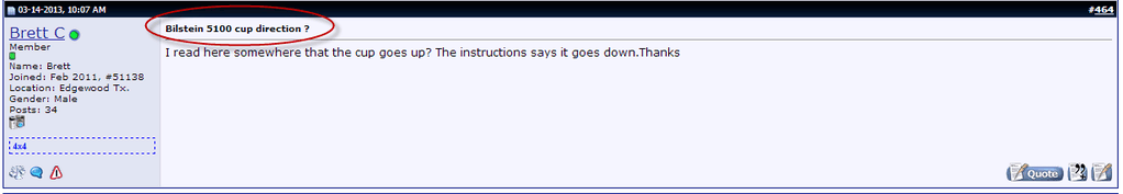

    I read here somewhere that the cup goes up? The instructions says it goes down.Thanks

    Peter North

    Coil seat ?

    It should look like a bell when installed correctly.

    for the 5100's , OME is the other way

    True. The title of his post referenced 5100s though.

    Yes, I put on the toytech springs awhile back , now I'm adding the Bilstein 5100's .

    don't see that

    Interesting , doesn't show that way on Tapatalk
