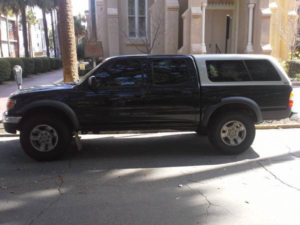

    okay, i have read this hole thread and i have a question about the 5100s. this thread is telling me that they only offer a 1" down travel because they are already a maxed out strut. Im not looking for a 3 in lift, maybe around 1.5 or 2 just so i can add more weight and keep it at factory height. If i only put them at around 1 or 20 in of lift, does that allow it to have another inch or two of down travel? Alos, if i only raise it up 2 inches max, will still need new UCAs to have proper alignment?
    one more question. how much down travel do the stock shocks have and how much would i need for a comfortable ride?
    thx for any help yall can offer. love the thread.
