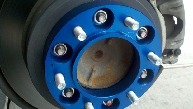

    ok if anyone can help.
    i have had a 6 inch fabtec suspension lift upgrade on my 09 taco. i have 33in nitto extream terrain mud grapplers with the stock 17 rims. after the upgrade i have noticed that everytime i turn that damn thing beeps at me is there a way that it can be shut up since it is so dang annoying. also with this there is a rub that i feel in the gas peddle and also a few times it is scary as hell it locks up and i start a skid. i have been back and forth to the off road place and he has no idea what could cause it except that the fact my tires are still to narrow makeing the vehicle think its loosing traction and its not can we say DANGEROUS any help is appreciated
    Brandon
  13. Apr 8, 2011 at 2:57 PM
    #133
    Namyo
    Namyo -
    Apr 28, 2010
    #36165
    14,133
    I believe you need wheel spacers or after market wheels.
