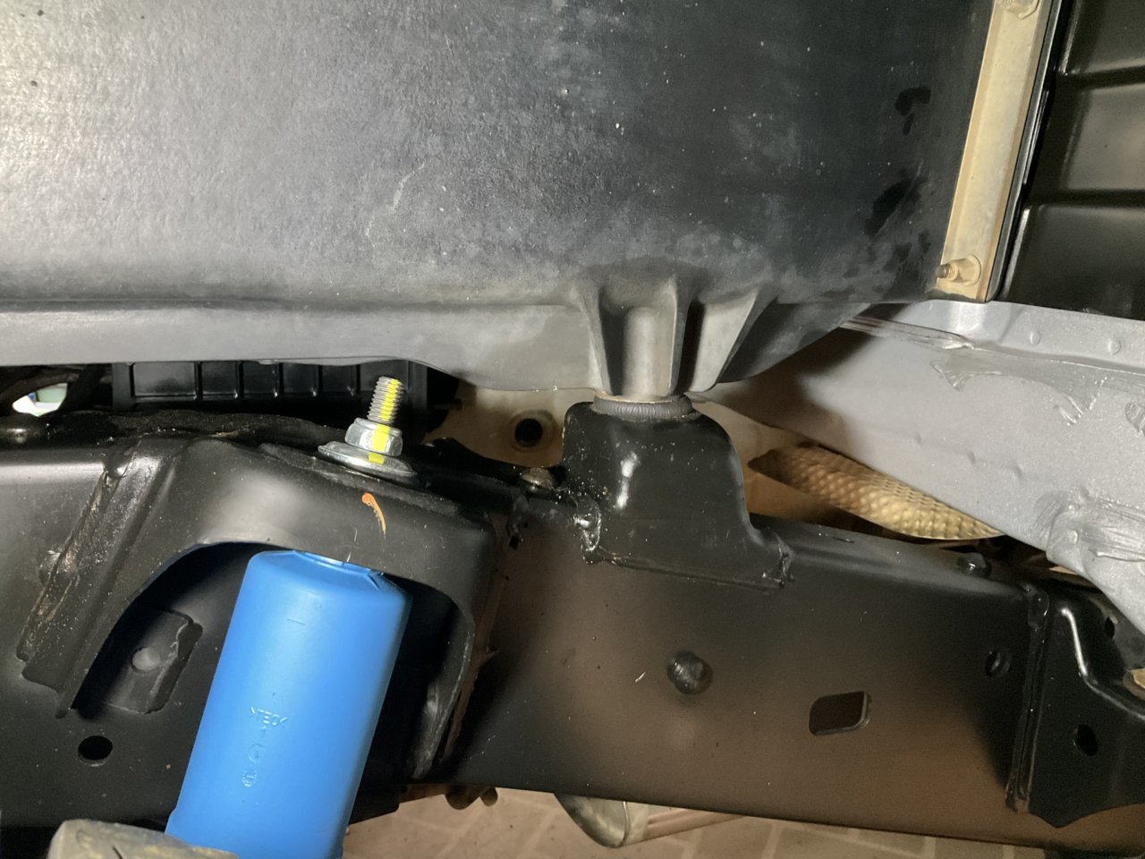

    This forum came through again for me. Did a quick google search for “Tacoma bed side rattle” and ended up here. Should’ve come here first. I had about 3/8 gap under my bed. The rattle started to drive me bonkers this week. I made two washers out of thick rubber floor mats. (Thanks Husky Liners for the lifetime warranty replacements)
    I used a Jack and 2x4 to raise the bed slightly from underneath. This allowed me to slip the two rubber washers in between the bed support and frame. Dropped the bolt back in, tightened, donezo.
    Spraying penetrating lube on the threads made bolt removal a cinch. Listen to the real ones on this thread. They know what they’re talking about.
    205742-CA-5-A6-C-4-DA1-8796-9-FE4847-C69_35da1a51fd85950f966c2eaece887d1bf9100f8c.jpg
    See! No more rattle. Pics don’t lie.

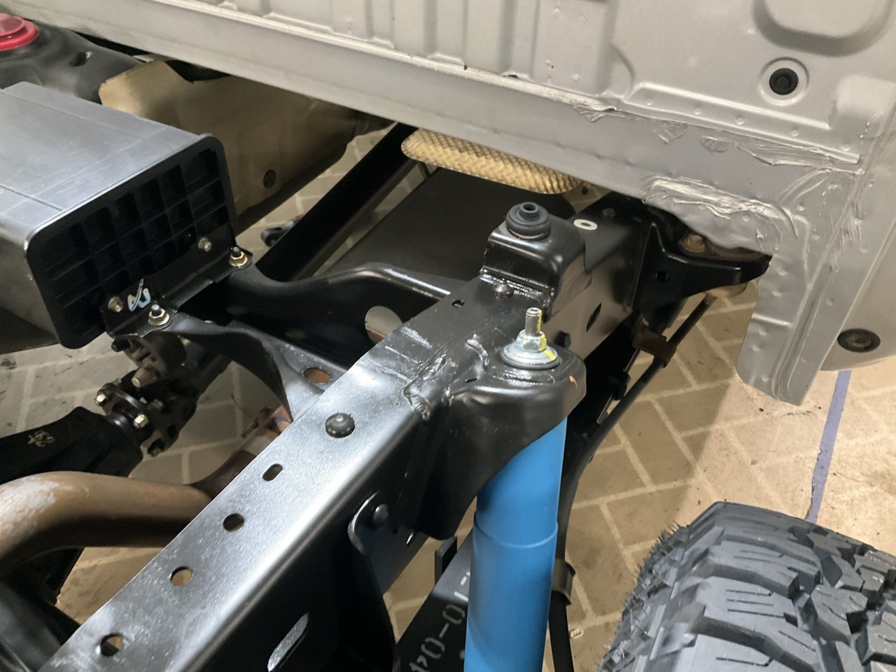

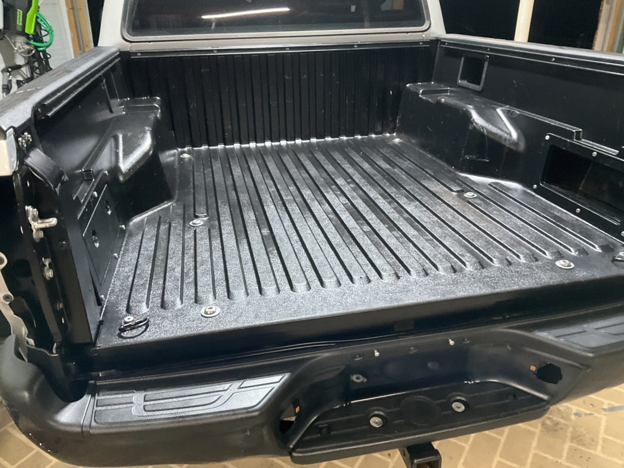

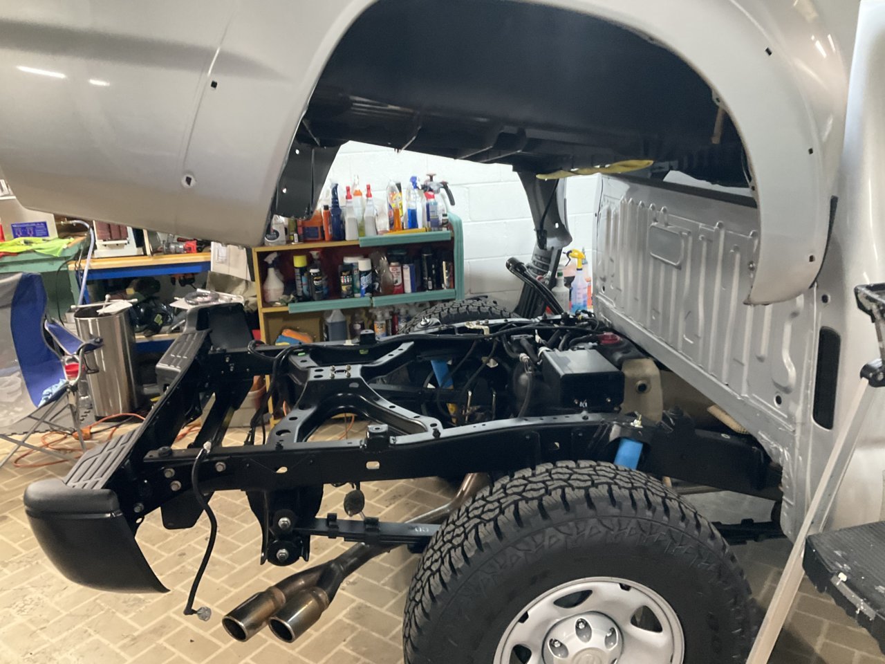

    bed back on and bolts back in.
    No play between the composite bed and the frame now.

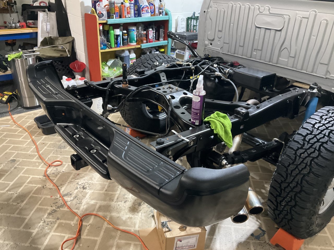

    8DE8E15C-5B5B-48BE-A1AE-F0D768067121.jpg I used silicon paste for the four bolts that are going through the rubber shock bushings and copper anti-sieze on the middle bolts that just touch metal.
    I had to remove the yellow recovery straps after the bed was lowered…a little rough getting them out by myself with the gas tank in the way.

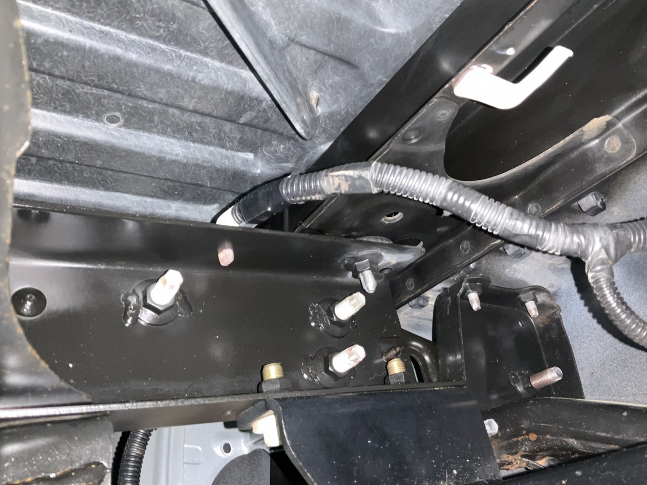

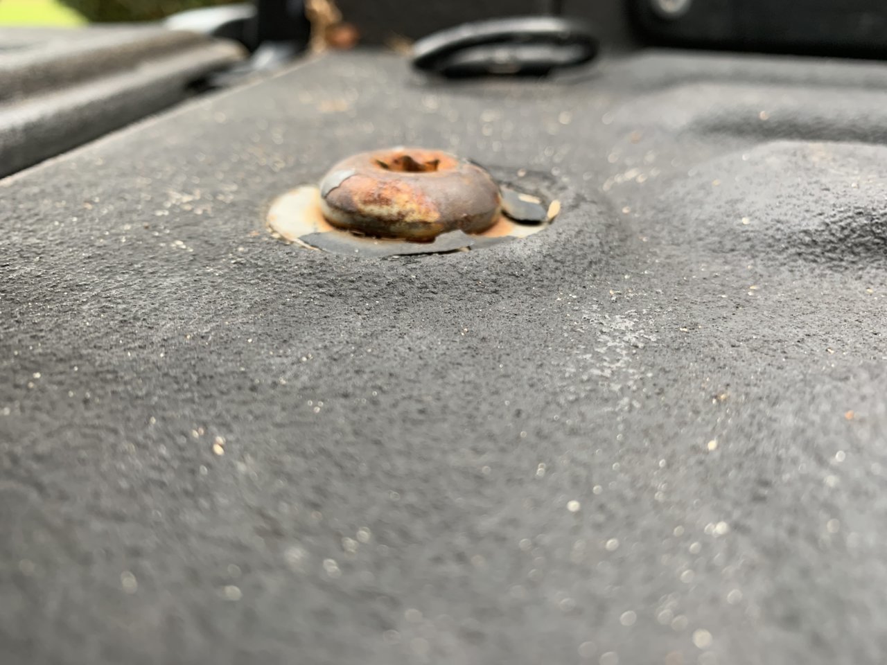

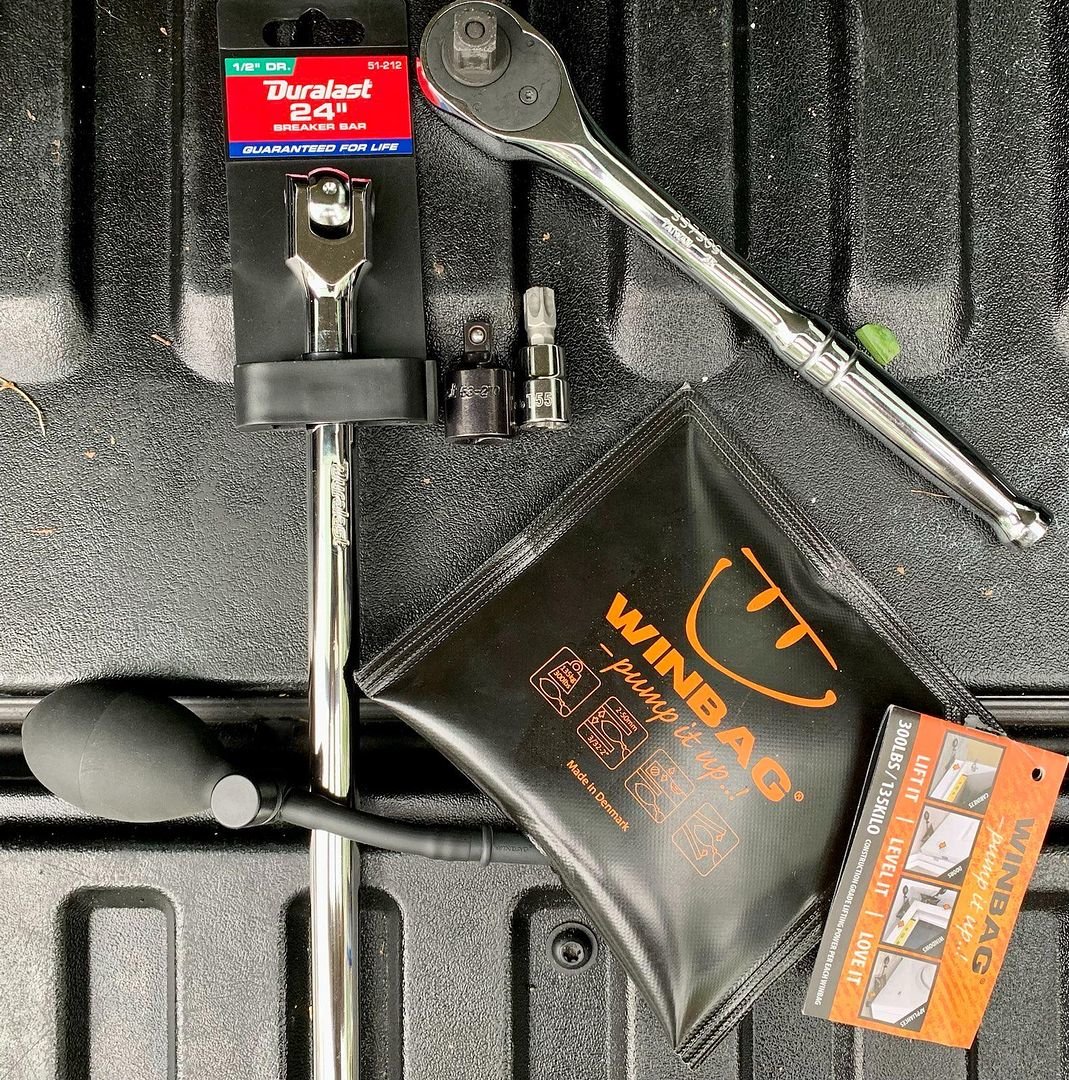

    I picked up a 2015 Tacoma Limited a few days ago and noticed a rattling noise. After ruling out the tools under the rear seat and items in the bed I gave the bed itself a shake on a whim and noticed it moved up/down. A quick search brought me to this thread which was a relief because it seemed to be an easy fix. I was able to secure the bed in about an hour after getting the right tools.
    • After removing the front passenger side bolt I saw exactly what others did, the metal sleeve protruding above the bed.
    • I had to get a breaker bar and needed every inch of the 24"; that bolt was tight. As someone else mentioned, I had to use the breaker bar for almost the entire process of removing the bolt. It wouldn't budge even with the 1/2" ratchet and penetrating oil until the end. I cleaned & lubricated everything pretty well before reassembly so I was able to use the ratchet to reinstall the bolt. I gave it a twist with the breaker bar at the end to get it tight.
    • I needed to use a 1/2" to 3/8" converter because I could only source a 3/8" T55 bit & a 1/2" breaker bar locally today. It all worked well though.

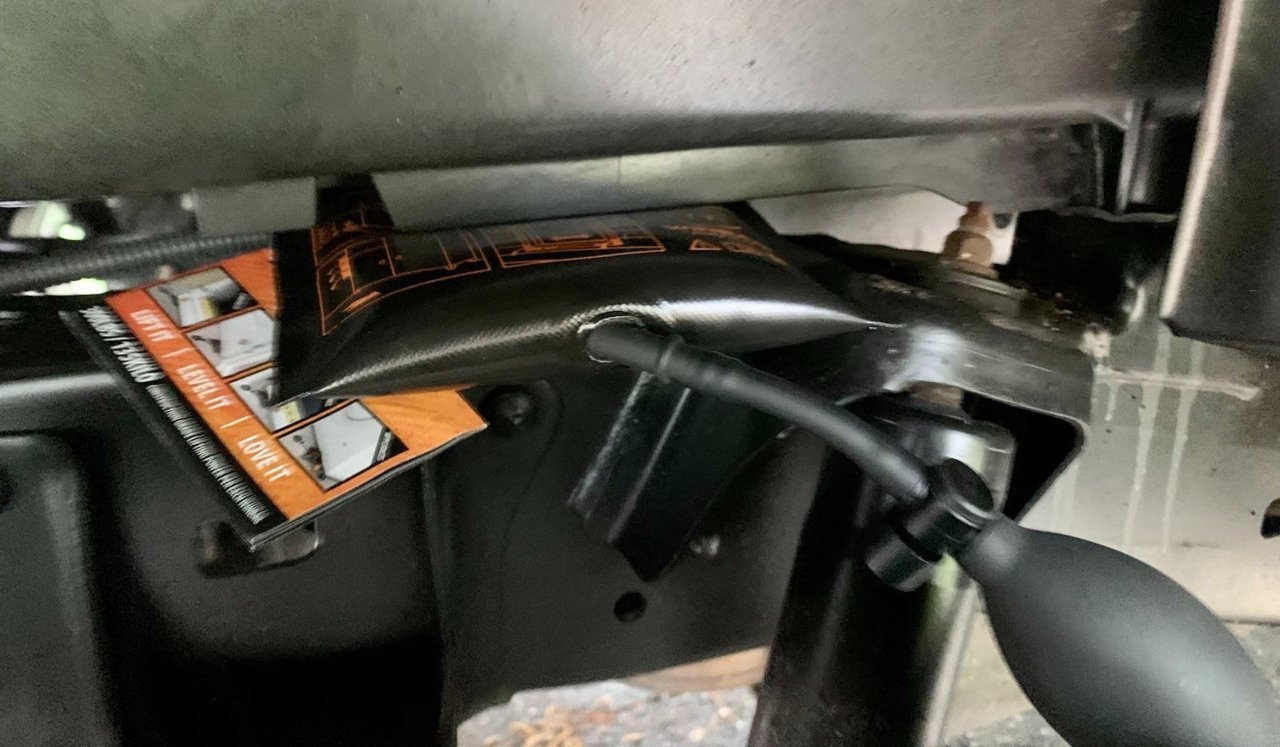

    • I used that Winbag to lift the bed up to create space to insert the washer. It worked really well for that. I loosened the other two bolts on the passenger side in hopes of avoiding undue stress. Those bolts worked out relatively easily.
    • For now I just used a 2"x1/8" rubber washer with a 1-1/4" hole in the middle between the bed & frame. I got it at Lowes. I wanted to prove to myself the fix would work for me and get the process down. Now I need to order the recommended more durable parts.
    Thanks everyone for the useful information here.
    All the tools I needed.
    The Winbag between the bed & frame. It really worked perfectly for this application.
    I didn't realize how blurry this was until I uploaded it for this post.

    Awesome idea with the winbag.
    Also I have to say, based on that one pic, you must have the cleanest 2015 frame out there. Congrats on that :D
