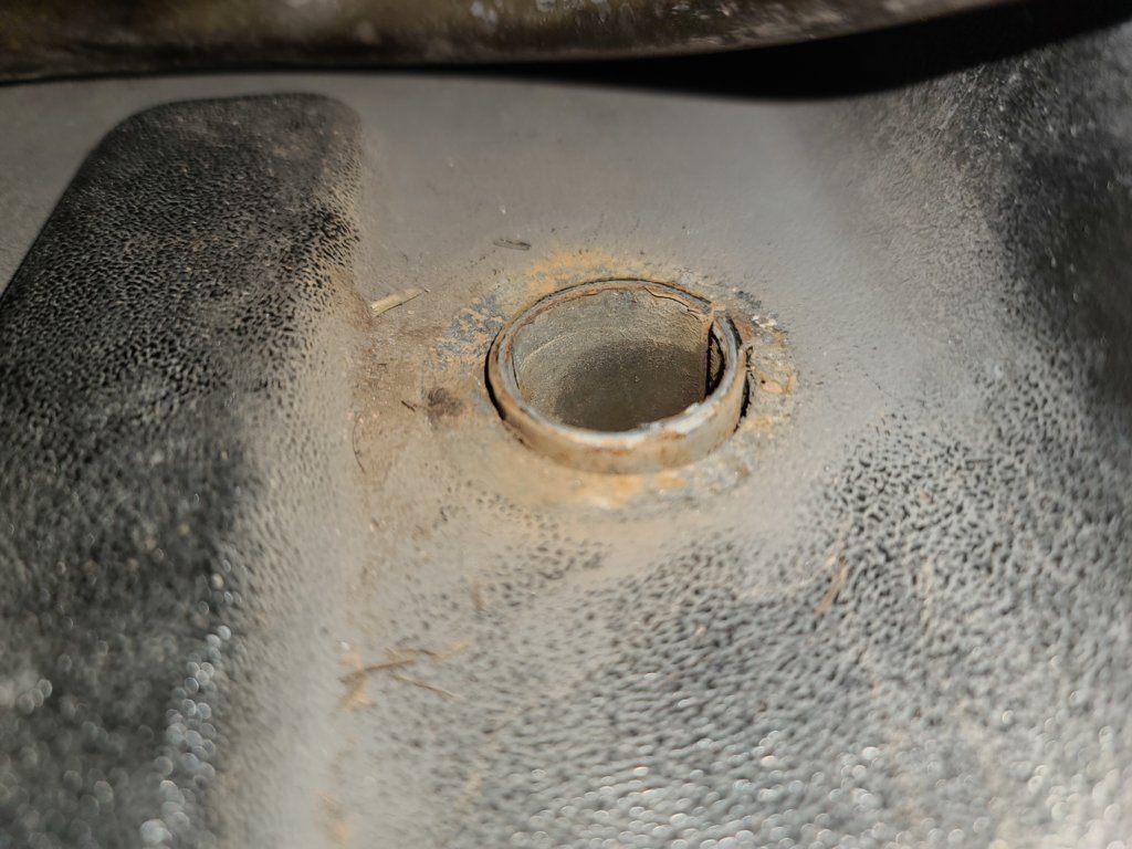

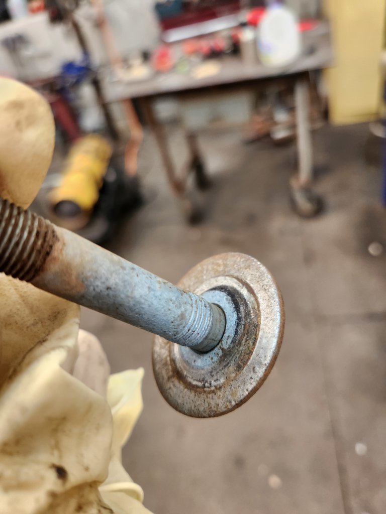

    I fixed mine today. Wasn't crazy loose but I could move the bed up and down a bit by hand and the bolt in that corner was a bit rusty. I ordered these washers from McMaster, https://www.mcmaster.com/product/95647A234 along with a fresh oem bolt. You can see that the 1 1/8" id washer fits just right around the od of the metal sleeve. I spun out the old bolt and lifted the bed with one of those air bag shims, held the washer in place with one hand and let the air out of the bag with the other. I put an obscene amount of anti seize on the new bolt and tightened it up and now it's solid.

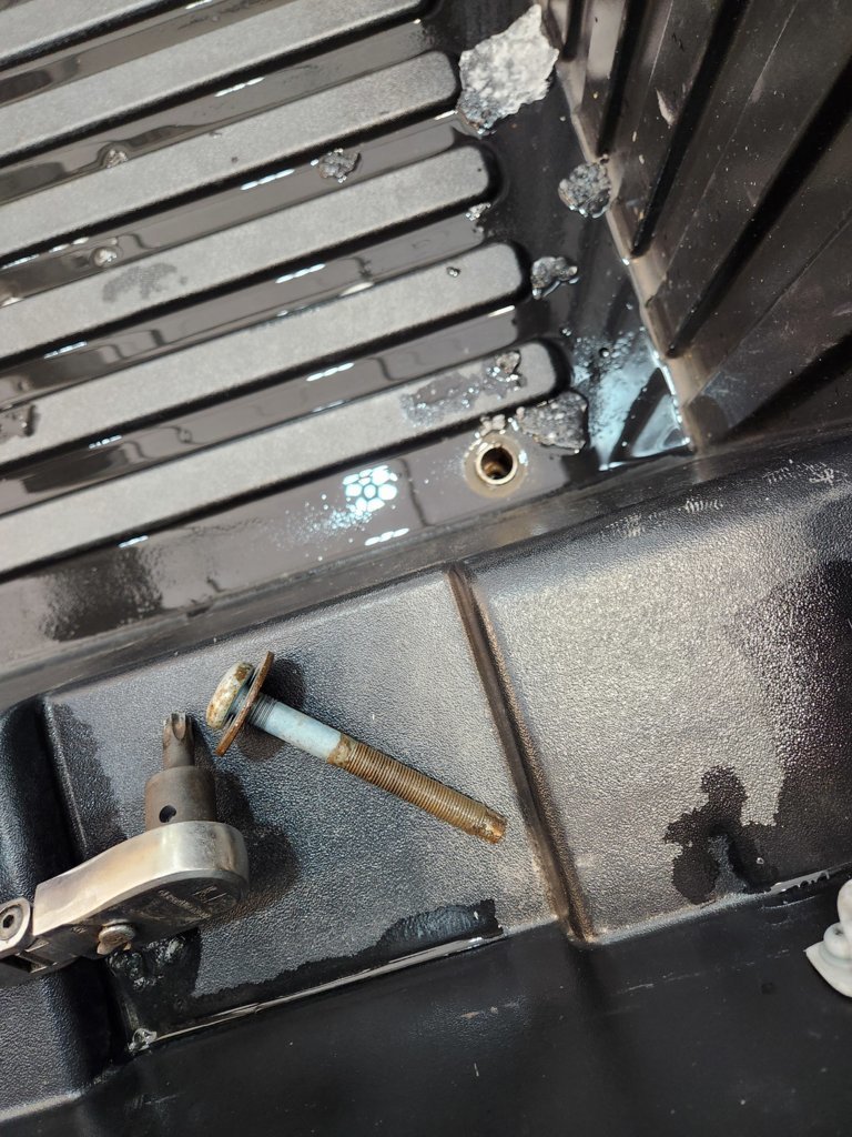

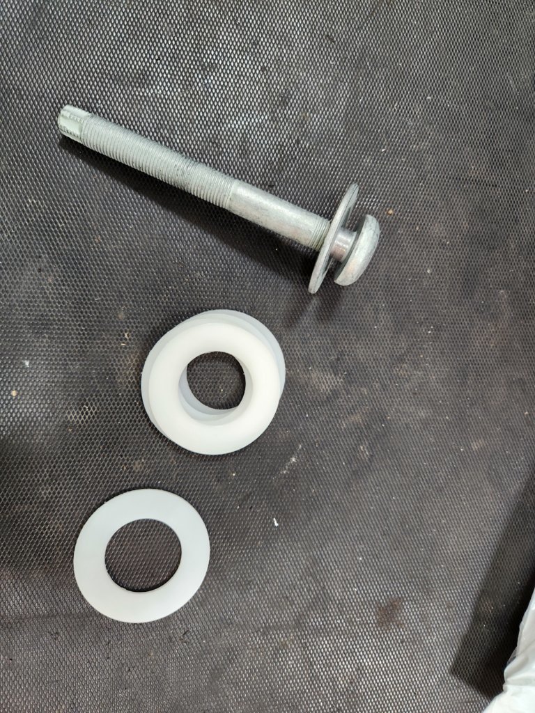

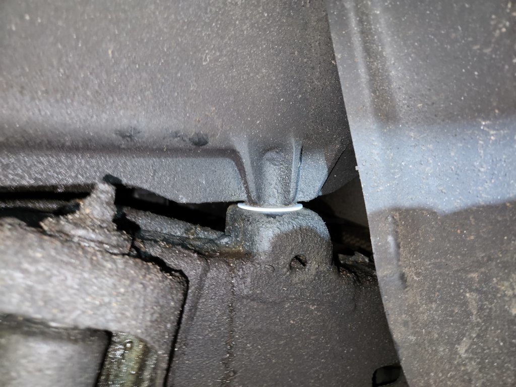

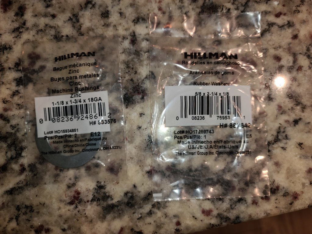

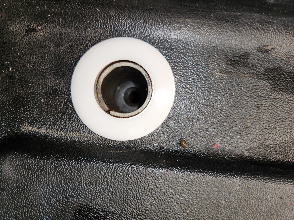

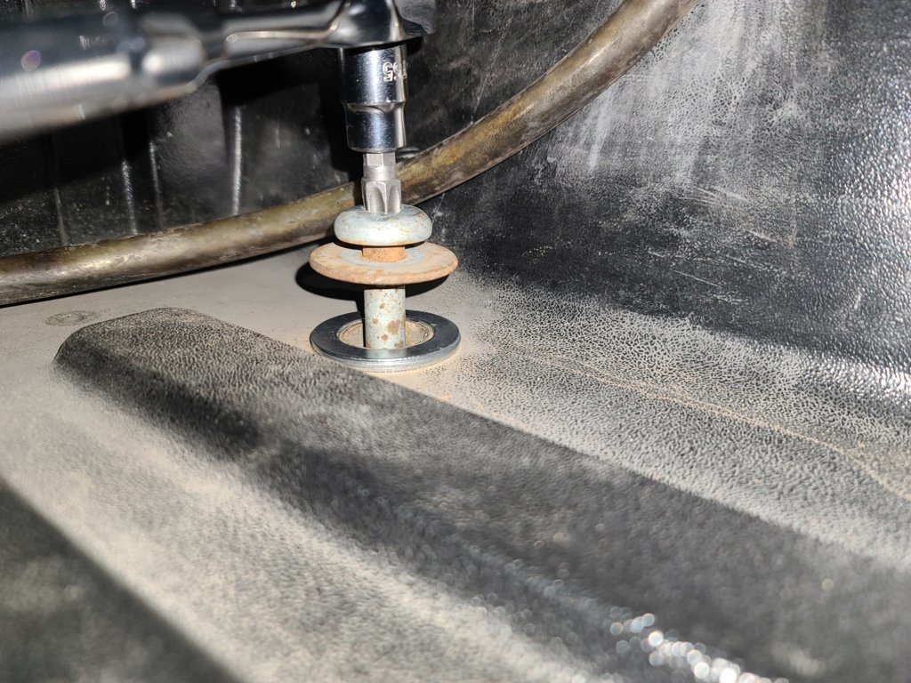

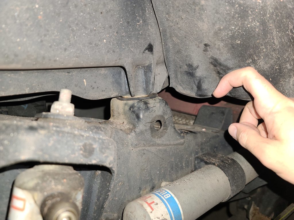

    Just did mine. Not too bad of a job. I used a rubber washer between the bed/frame. No more movement :) Lowes didn't carry the T55 torx so had to trek to a Home Depot20250202_171114.jpg 17385516497636735341356356015562.jpg 20250202_185317.jpg 20250202_185337.jpg
