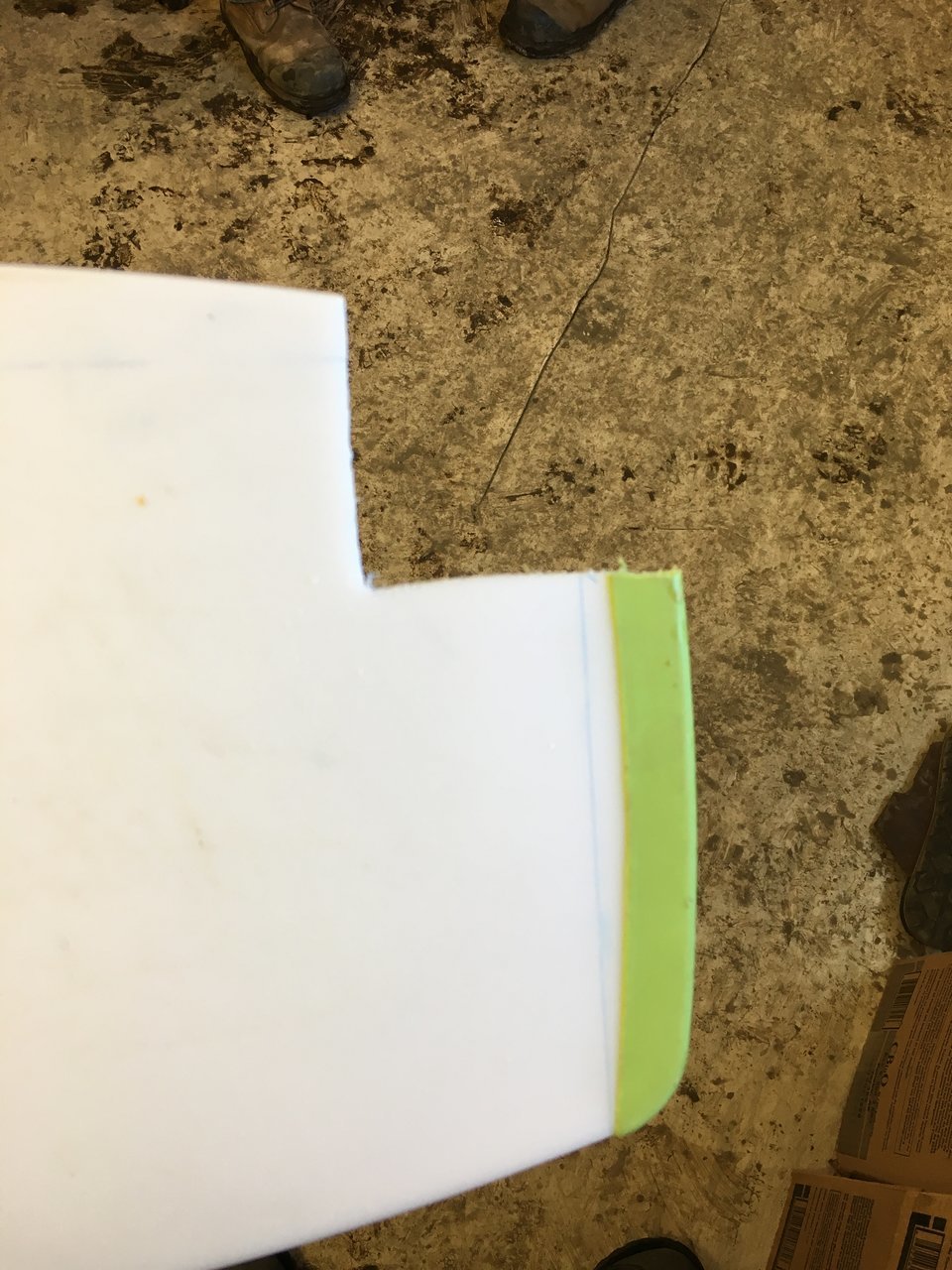

    Well, this has to be the easiest fix in the world. Sadly my cutting board will never be the same. It was the perfect fit that i needed, well maybe 1-2mm thicker but that is not a big deal. Gives me room to righten if need be.
    I had limited tools as the service truck was in the shop, hack saw bad and the largest paddle bit I could find. Just big enough to fit the metal sleeve.
    2"x2" piece about 8mm thick, voila, truck sits perfectly and no matter chatter when driving.

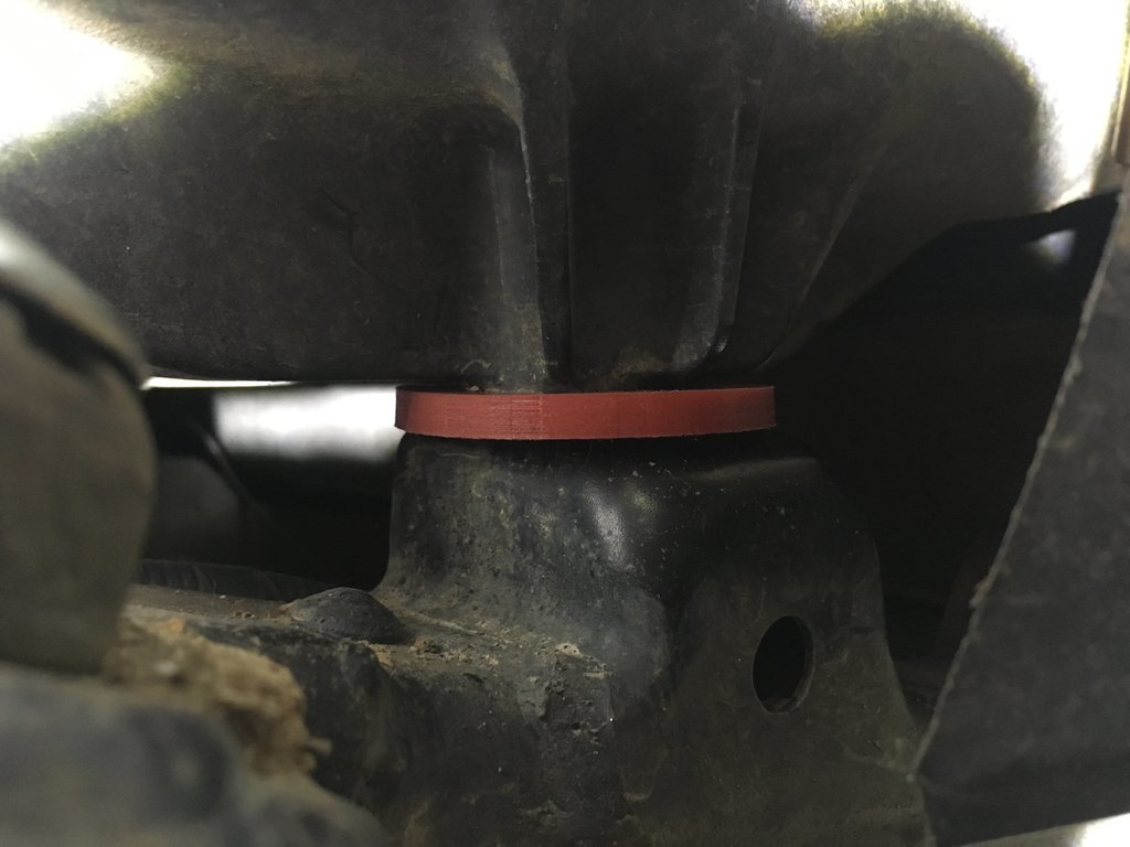

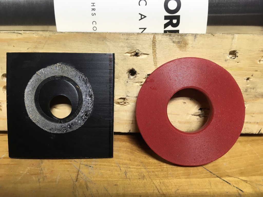

    Old thread, but want to contribute in my small way. I first tried a 1/8" piece of UHMW sheet drilled to a size that allowed the bolt to pass through; didn't last long and the thump came back. Searching for a thicker material to replace it with, I stumbled upon a car wash manufacturer in Inglewood, CA that has large UHMW washers in their parts list. Based on the wear pattern on my first attempt, my thought was that the material needed a larger hole that would accommodate the OD of the metal sleeve in the mount.
    This pic shows the wear pattern on the top of the first attempt and the washer that replaced it. Note the area that was compressed by the mount sleeve.
    Here it is on the truck. Bottom line is, drill a hole just large enough to let the sleeve pass through. Did this 6 months ago and have not had the issue return.
