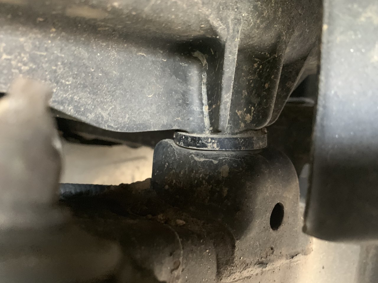

  13. Jun 7, 2019 at 5:21 PM
    #153
    Hyland33
    Hyland33 Well-Known Member
    Aug 8, 2017
    #226316
    581
    Andrew
    Leicester, MA
    2015 Tacoma TRD Offroad
  14. Jun 7, 2019 at 5:44 PM
    #154
    Wakecoach
    Wakecoach Kiwi in FL
    Jun 16, 2016
    #189760
    396
    Kurt
    2015 White TRD Sport 4x4 2001 Subaru Legacy Wagon Bilstein Touring Edition
    King ext, res/adj...3leaf Aal. ECGS bushing. Bullaculla relocate bracket. Pelfrey bilt skids. TC UCA. K+N, Weathertech Mats, TRD side steps, BROV Tacoma Attic, Prinsu Cabrac, TRD OR Tow Hook
    I think this might be the diagnosis that Ive been hearing. But can’t locate ... Didn’t know this was a thing.
    Flippin TW to the rescue again
    Thanks

    Could you dig up a part number and post it?

  17. Jun 8, 2019 at 6:40 AM
    #157
    Taco'09
    Taco'09 Well-Known Member
    Dec 31, 2008
    #12073
    1,877
    Good work, but almost $7 ea. + McMaster's outrageous shipping charges could add up especially if you did all 6. Remember the rear two bolts are also a different size. Still, I've spend $$$ on my truck many times before without griping so.....
    @Hyland33 Can you please describe if these are a hard plastic or more like a rubber bushing?

  19. Jun 8, 2019 at 9:12 AM
    #159
    Hyland33
    Aug 8, 2017
    #226316
    581
    Andrew
    Leicester, MA
    I only did the one that was needed which was the front passenger side. They are a very hard rubber material.
