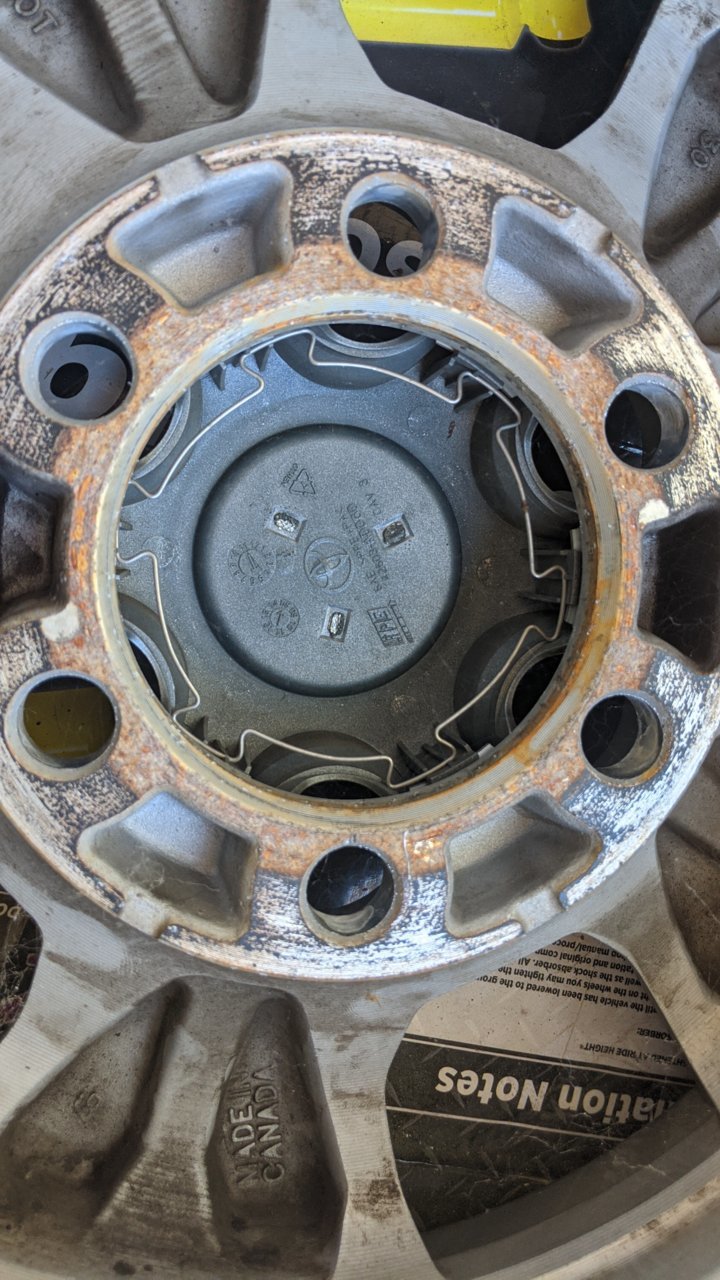

    They are typically held in place with a spring (that's the case with the aluminum ones on my truck and that retention method is pretty common, but double check yours). If you push from the back they should pop right off. If they are being stubborn you can get a screwdriver to pop the spring out.
    On my aluminum wheels:
