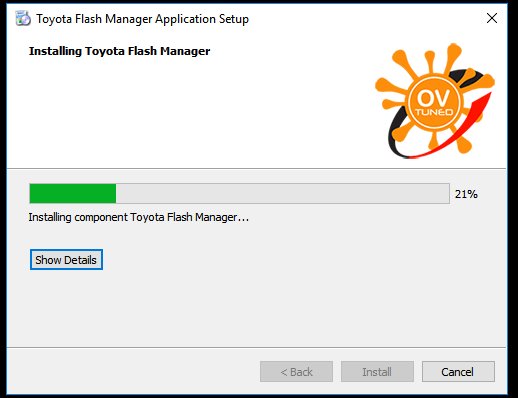

    Please be sure to review VF Tuner instructions: https://cdn.shopify.com/s/files/1/0...stallation_Guide_Ver_1.2.9.9.pdf?v=1617197284
    tech guides can be found in your INSTALLATION FOLDER (C/program files / vF Tuner)

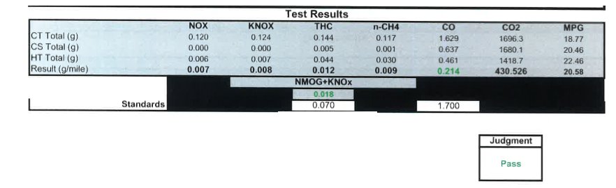

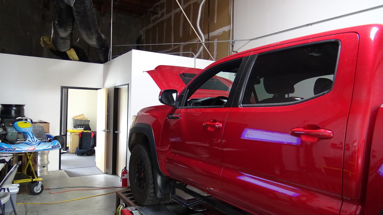

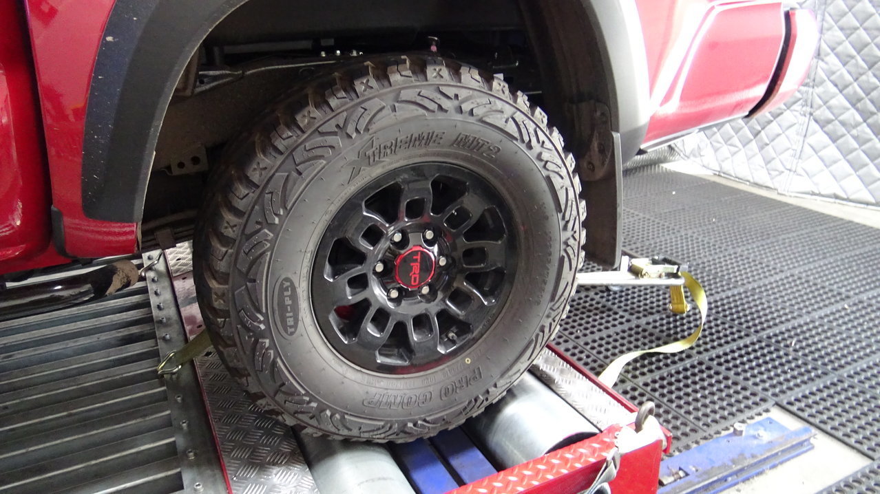

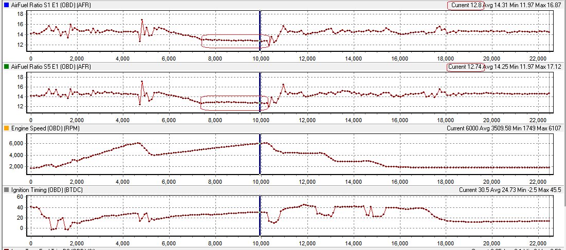

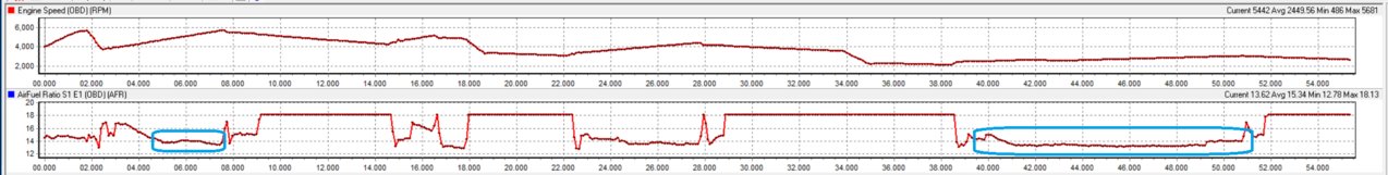

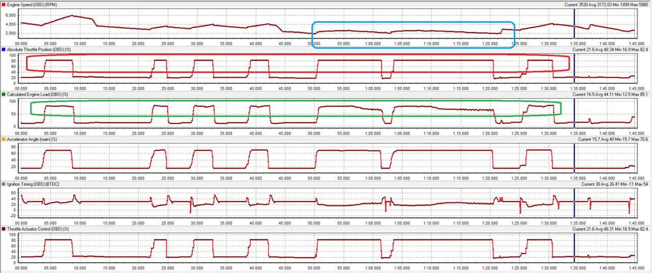

    OVTUNE TEST TRUCK:
    2017 tacoma TRD PRO 4x4 with No engine Modifications and larger tires
    Independent Emissions Test
    (our product is for off-road use, however we value the environment)
    [​IMG] [​IMG] [​IMG] [​IMG]
    [​IMG] [​IMG]

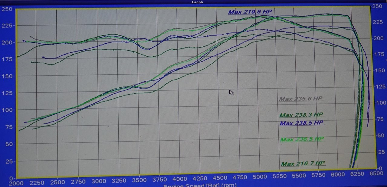

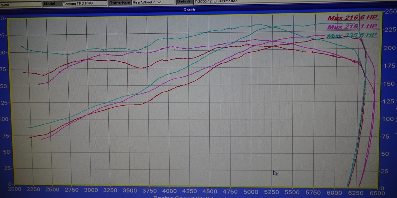

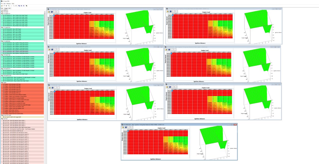

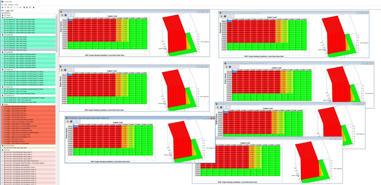

    The ECU does not use the traditional means of tuning that we are all accustom to. where you get an ignition map, fuel target, throttle, and other simple stuff.
    Not at all. Rather the ECU uses...This is a little difficult to explain actually but I and some colleagues call it "5D" mapping, where the ECU will continuously alternate through 16 different tables in a "flip book" like fashion based on various sensor feedback and accelerator pedal to calculate a resulting "amount of power to create".
    That's just 1...1 part of a spider web of processes.
    STOCK ECU Reflash
