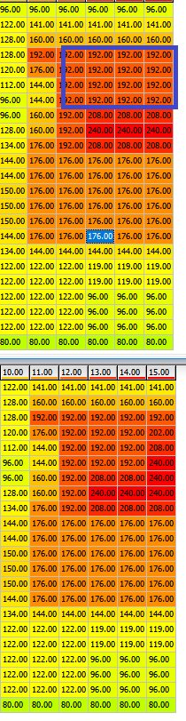

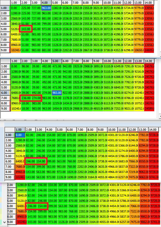

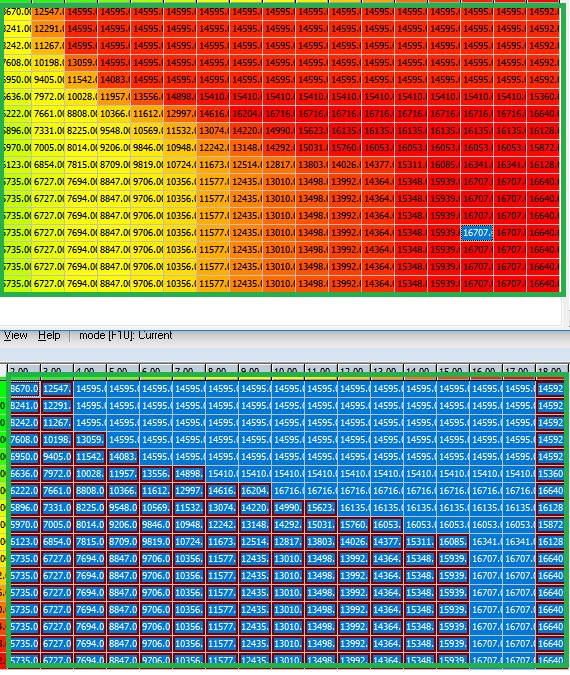

    Before 04B04 tune releases, here is some reading
    material regarding this latest update.
    Lets start with Throttle.
    Toyota fixes the issue in a interesting way.
    Now there are many more tables that are changed in 04B04, but here is a highlight
    Starting with Valve Timing
    Toyota reduces valve advance on lower RPM and high throttle or higher loads. This likely is used to create smoother operation at the slight expense of available torque.
    Image with circle is new ECU version
    next we have changes to Torque Models. The top image is the new TSB
    This table softens transmission response for shifting (softer shifting). Moderate and low load areas have been changed to soften / smoothen shifting during normal (non full throttle) operation

    Next throttle tables.
    This update changes some Throttle targets based on speed and gear. Now a few nice things toyota did was some smoothing and increasing of throttle targets (target angle) vs older ECU versions. However the problem areas are changed by either a large increase or large decrease based on very low accelerator angles, as you can see circled in red. So the throttle will just jump open more, or close more, if you're within that driving speed and gear (and accelerator angle)
