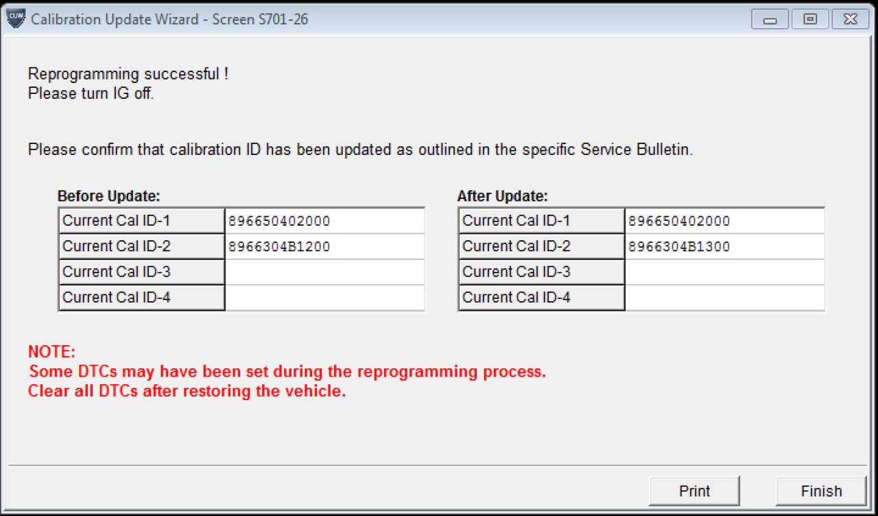

    Just updated. We'll see what its like on my truck

  18. Aug 12, 2018 at 1:11 PM
    Shellshock
    Nov 21, 2015
    #170338
    23,480
    Iowa
    So after a few miles, I’m not even sure what to say. It seems Toyota got finally got their act together with the factory tuning because it is night and day different from the steaming pile of garbage they shipped with the truck.
    I’ll echo what others have said that it is definitely smooth and any of the weirdness is gone thus far. I have noticed that it doesn’t feel as powerful down low compared to 1.04A.
    I’ll definitely still be flashing 1.05 once it is available because once you combine this with the OVT magic, this truck is going to be amazing.
