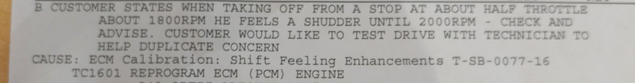

    The latest revision of this TSB has been out since last November, and unfortunately it will not resolve the described concern. (or at least it will not fix it beyond the short term learning phase)

    I thought about that but wasnt sure if the original tune was based on something and if I reflashed would the dealership flash cause problems. I emailed to OV and sent the dealership flash, am waiting his reply. Im in no hurry for anything.

    I just changed my ckp and flashed back to the tune. Will report @OVTune

    I changed the ckp sensor. The Maf is clean, It improved the idle and made it smoother. The stock tune felt really smooth. Flashed the OV alpha 1.01 back to it and it still has the stutter. I will put some miles towing with it this weekend. We will see how it does.

    Can you pm me your name or order number I want to see what ECU version you have.
    We did our development on 04B03. I really want to pin point this stutter.

    will be confirmed tomorrow but 99% sure the stutter has been found and solution has been made. it is fixable via reflash

    I believe you are right. Thanks for the great work you do. You are the taco wizard buddy.
