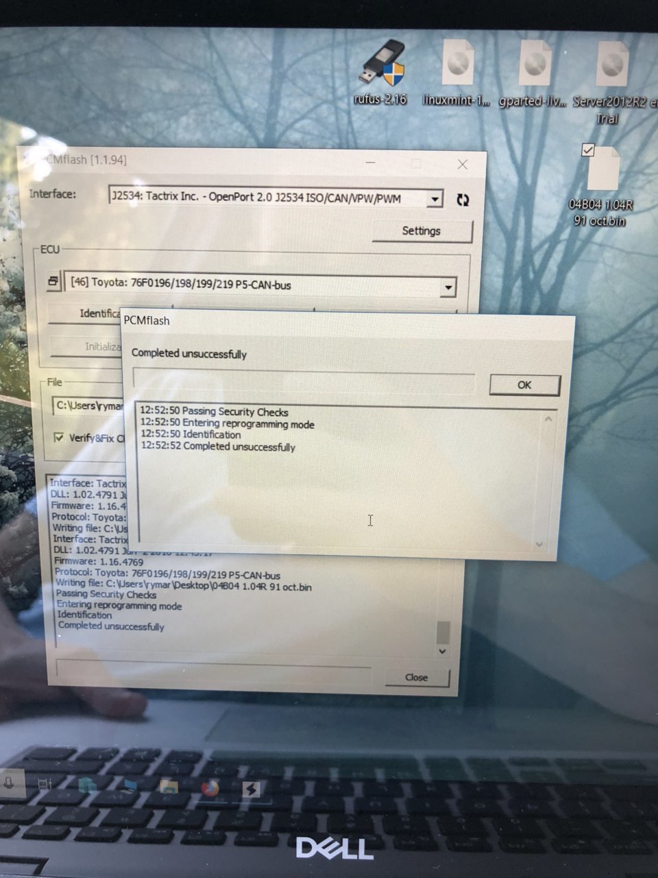

    Does anyone have flash manager they can link me to? Want to try 1.04r, but have no flash manager

    Getting this

    you have already applied or had the dealer do the latest TSB to get B04 ?
    also would make sure all electrical load is off, and if you haven't started your truck in awhile a start up and warm has helped others in terms of battery voltage and whatnot.
    otherwise mine used to end unsuccessfully a lot when I was using a virtual machine on my mac. I just kept retrying and eventually it always worked FWIW
    I see you're on a windows PC so that's likely not it, but I would turn off all other communications on that laptop (bluetooth, wifi, networks, etc.,)

    OK - If you are still on B03 then the file intended for the B04 ECU won't flash. Part of its checks to confirm compatibility before it can flash. You'd have to have either the dealer flash the B04 (latest TSB) ECU version OR you can get the files and a copy of TIS in this thread (And others) somewhere through searching and DIY. Can't flash 1.04r with B03

    Had that happen to me - I failed to push the START button the required two times. Once I figured out my screw up it all went per instructions. ??
    Or as @bshammer0 has identified you can not do the flash without the TSB for 1.04R first.

    I’m in accessory mode when trying to flash. I think the issue of it not being B04 makes more sense

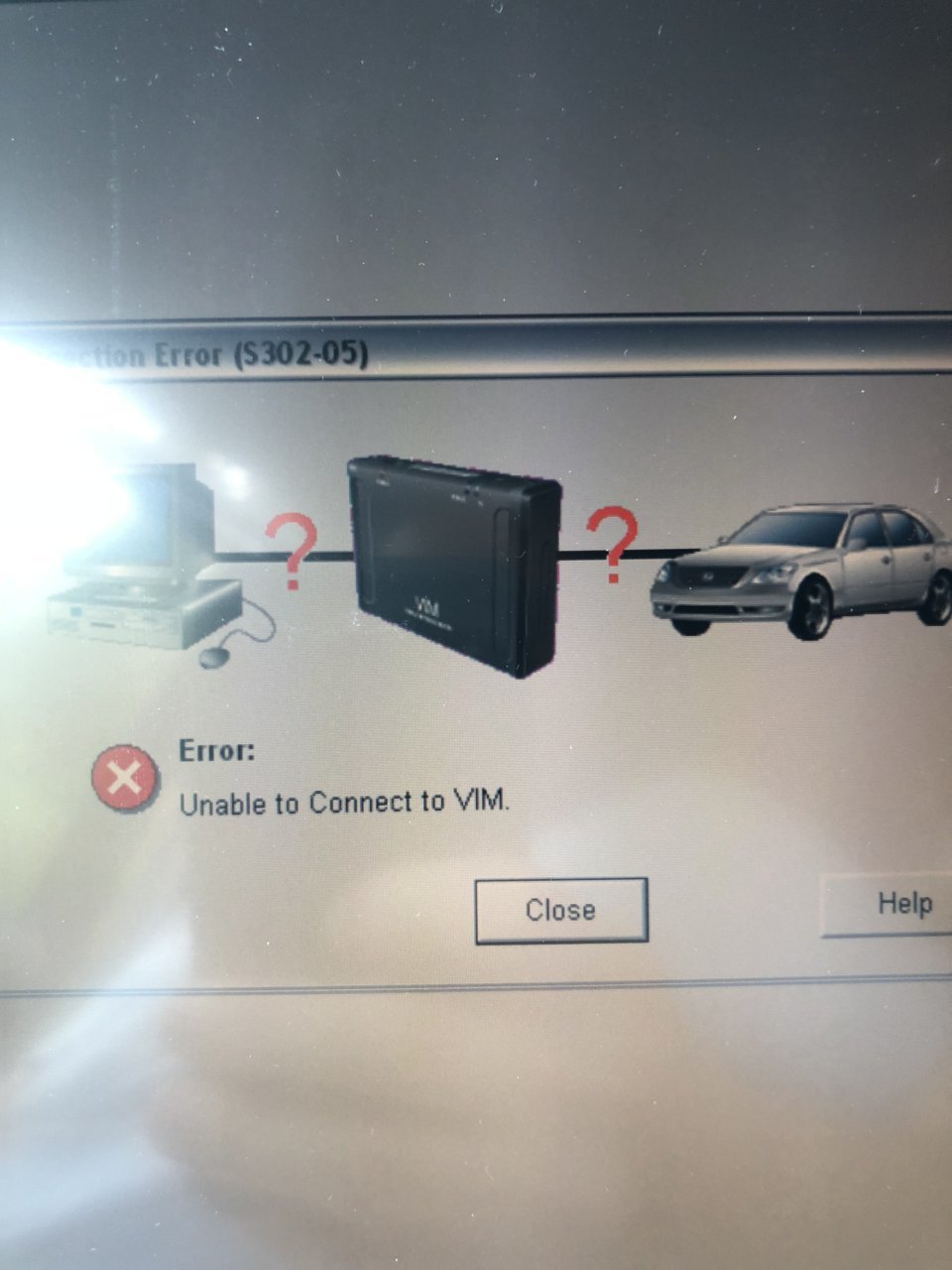

    Installed tis but getting an error with that too lol

    Yes, you need to be at B04, but also you need to have the ignition ON, not accessory mode.

    Not sure on that - but you may need to go into your TIS settings to select the proper interface so it's using the OpenPort adapter (Tactrix). So long as you've selected the right adapter and have everything hooked up and your truck ignition on (engine off) it should hook up easily.
    Once you have TIS installed and working, you don't actually have to open TIS again to use the CUW file as it becomes an executable file with an embedded installer package (still requires you HAVE TIS installed to be compatible with the file types and interfaces)

    Right, that what I meant

    Good call, I didn’t bother to check. All works
