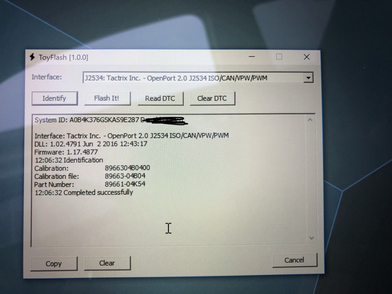

    Just went in for service. Told me they did the latest TSB for the trans. No TSB number is noted on the paperwork. I flashed back to the stock tune from 1.04. When I got home I attached the tatrix cable and did an identify. Below are the results. Can someone advise which update this is if any? Thanks for the help.

    04B04 is the update calibration file from the TSB. You're on the latest from Toyota.

    Ok thanks for the quick response. So I would need 1.04R to flash again correct?

    Yes

    Can't just go from 1.04 to 1.04R without getting the latest TSB done at the dealer or do the TSB yourself if you have Techstream and CUW file.
