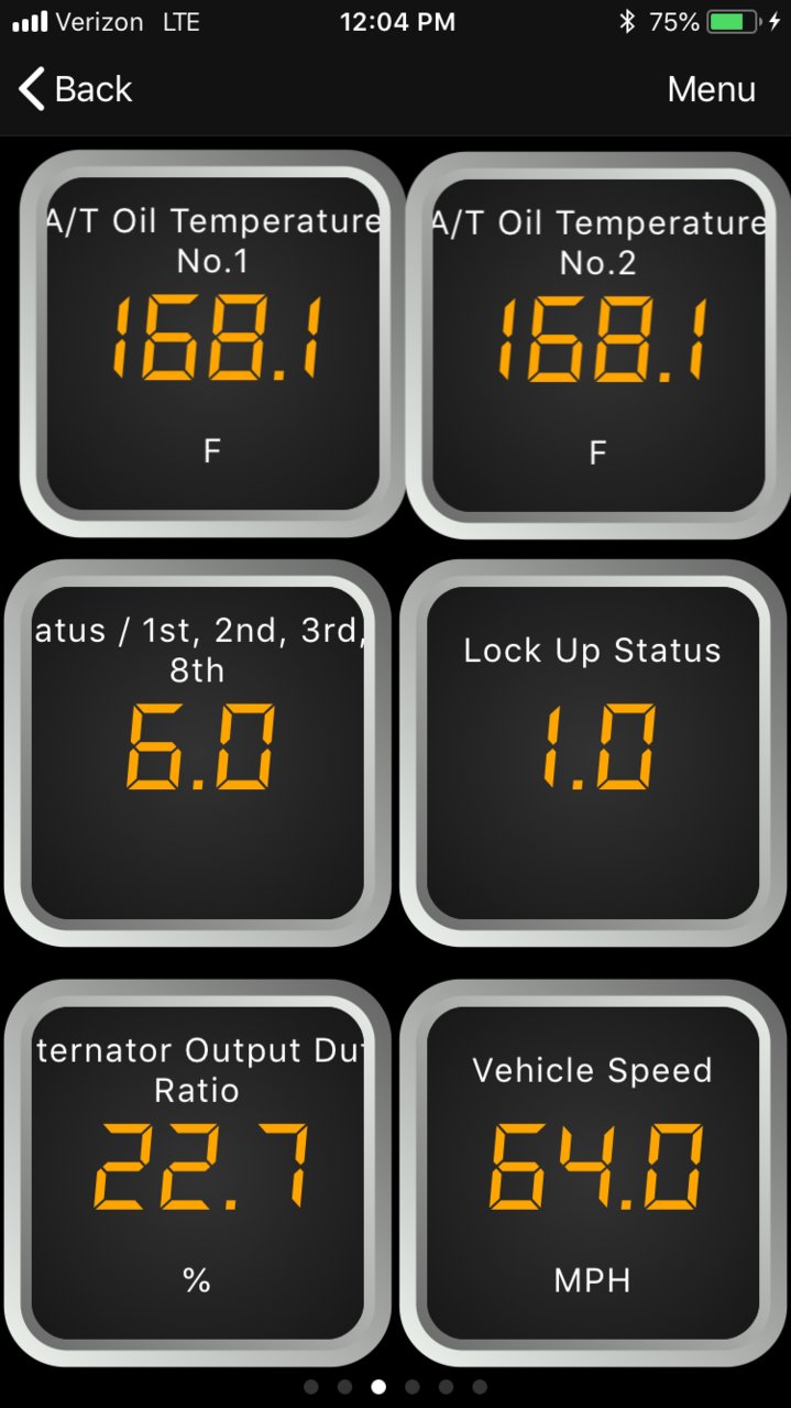

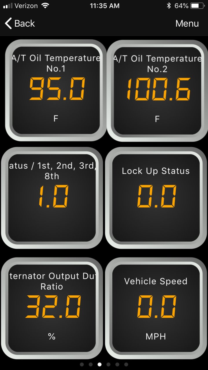

    @OVTune
    I’m interested in the increased alternator output you mentioned earlier.
    I’ve observed the output to drop anytime my truck is not at idle. I don’t remember output changing with load also, all lights on or arb compressor kicking on.
    Can you increase the output voltage to 14.4 to 14.6 and alter how the amp output under load.
    The factory charging seems to be aimed at fuel economy not a full charge or full output under heavy load.
    Here are two examples.
