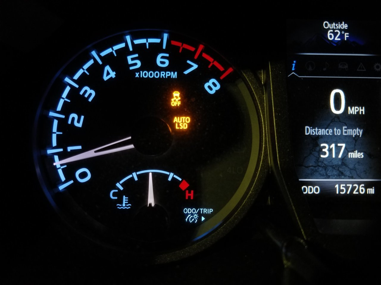

    He says he turns the auto LSD on and drives around with it. The manual specifically states not to do this as it'll brake the inside wheel.

    You are mostly correct but in reality it seems to be a non-issue. In my experience Auto-LSD won't interfere during normal day to day driving in good conditions. It's pretty good about knowing when to step in and when not to. That being said there's definitely no reason to be rolling around with it on all the time in good conditions.

    Am I crazy, or isn't it on ALL the time stock?
    Pressing the button, turns it OFF.

    1,822
    San Diego
    Its only on when you turn traction control off

    I'll agree to disagree Sir.
    In my limited knowledge, the lsd is always on. When I pressthe button and OFF illuminates, it's turned off and allowing the back wheels to break loose under power, vice cutting power when they break loose.

    You can press the button and hold it.

    I had to double check. AUTO LSD is always off unles you press the button then it activates auto lsd. If you hold the button it deactivates traction control and auto lsd. ABS brakes are still active though.

    All I know is when I pressthe button it lights up OFF.
    In the winter, it cuts power when the wheels spin. Meaning, it's activated. When I press the button and OFF illuminates, it stops cutting the power, letting the wheels break loose.

    No. It's off by default and pressing the button turns it on.
    The "OFF" indicator you see on the dash when Auto LSD is turned on is telling you that VSC is off. There is also an Auto LSD indicator on the dash that illuminates when Auto LSD is on.

    What he said^^^
