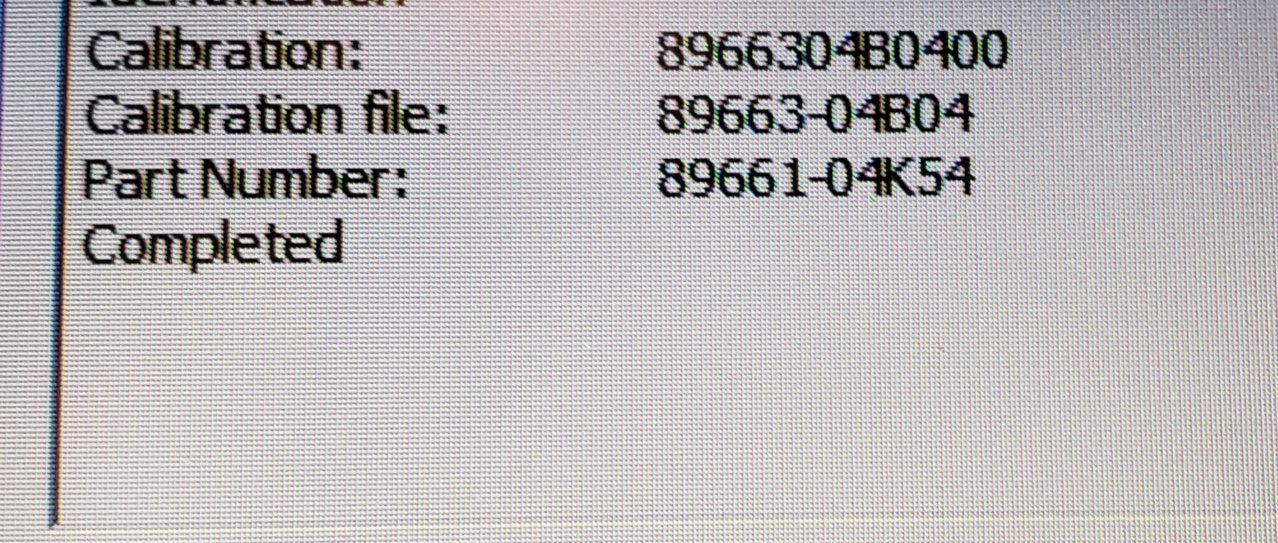

    On the way home it felt like it's shifting differently, which leads me to believe they actually did it. But I do want to verify. I installed techstream version 12.20.024. Do I need to download a specific driver for the tactrix cable? Would you mind telling me the steps to check for an update? Also, isn't there a setting I have to change in order to connect to the truck ? Thanks

    I found a flash drive with all my software! Does this mean I'm up to date with the TSB? Thanks20181017_164205.jpg
  4. Oct 17, 2018 at 5:06 PM
    20tacoma17
    20tacoma17 Well-Known Member
    Nov 8, 2016
    #201910
    7,079
    2017 DCLB Sport AT
    Kings, 275/70/17, a few custom items, lots of Meso mods.
    Is there a way to see what software and tsb's I have with an OBD2 scan tool? I've had mine in for 2 tsb's but there are no stickers under hood.
    Thanks
  5. Oct 17, 2018 at 5:50 PM
    iPaint
    iPaint Well-Known Member
    Dec 30, 2016
    #206047
    237
    Nebraska
    2017 TRD OR DC 4x4 AT
    Yep, 04B04
    They didn’t put a sticker under my hood when they updated me from 04B01 to 04B03.
  6. Oct 17, 2018 at 5:50 PM
    Anchovy
    Anchovy Rule #1: Never take me seriously
    Sep 4, 2017
    #229096
    6,387
    TRD Ferguson
    2016 TRD Off Road (OVTuned)
    They aren’t going to put a sticker under your hood for a tsb. You also aren’t going to see if you have a tsb with a scan tool. A tsb is a technical service bulletin, basically means it’s a service thing that Toyota says they have a solution for a common issue

    Thanks, just trying to make sure I have the right calibration for the handheld unit. Requires OB402 or higher. OB400 and OB401 not supported. Nothing on my service writes up. Each time just states TSB rev1 or 0058 were performed. Thanks tho

    You're a '17 so chances are that you already started off at 4B02 but Rev 1 would set it to 4B03 and 58 would put it at 4B04
    4B00 and 01 were only on '16s

    I've seen 04B04 and such mentioned here quite a bit. Got my 18' at the end of July, and don't really know how to interpret this:
    Calibration: 8966304A6000
    Calibration file: 89663-04A60
    Part Number: 89661-04K20
    So do I have an older file than 04B? I would think so, A B C etc., but all of this is completely new to me.

    You have an '18. In '18 the changed the numbering system to account for the crash sensing crap that is written into the ECU.
    '16 and '17 were the 4B00-4B04 series and '18 started at A600 and now A610
