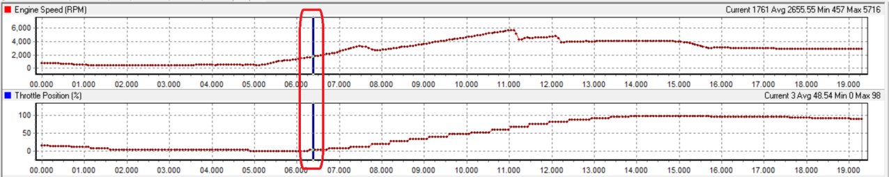

    in case you guys want to see what I'm talking about... here is a datalog snip of toyotas "throttle intelligence"
    The area circled in red is where we floored the vehicle. Look at how the throttle responds

    Are the dips in RPM shifts? I see 5 dips..so did you floor it in 1st? How come RPM stays flat once its in 4th and yet throttle position continues to increase? I'm probably reading the graph wrong

    You are reading this correctly, sorry I should clarify this isn't a tacoma, but another toyota vehicle with the throttle intelligence code (the code is identical, exactly the same from the Tacoma to the NX200, IS200, LC500H, etc)
    There is, from what we see, a lag from throttle response to throttle reduction. We let off after 3rd gear and coasted down. It was at full throttle while we were coasting
    We never managed Full throttle while actually trying to get full throttle

    Ah I see. So the throttle position graph is what the ECU is allowing? So once you start coasting in 3rd and it downshifts it's not actually wide open throttle but it would allow wide open throttle at that time if you were to floor it again?

    not exactly, from what we see. I'm investigating further but I believe it may be a way of psuedo-engine braking
