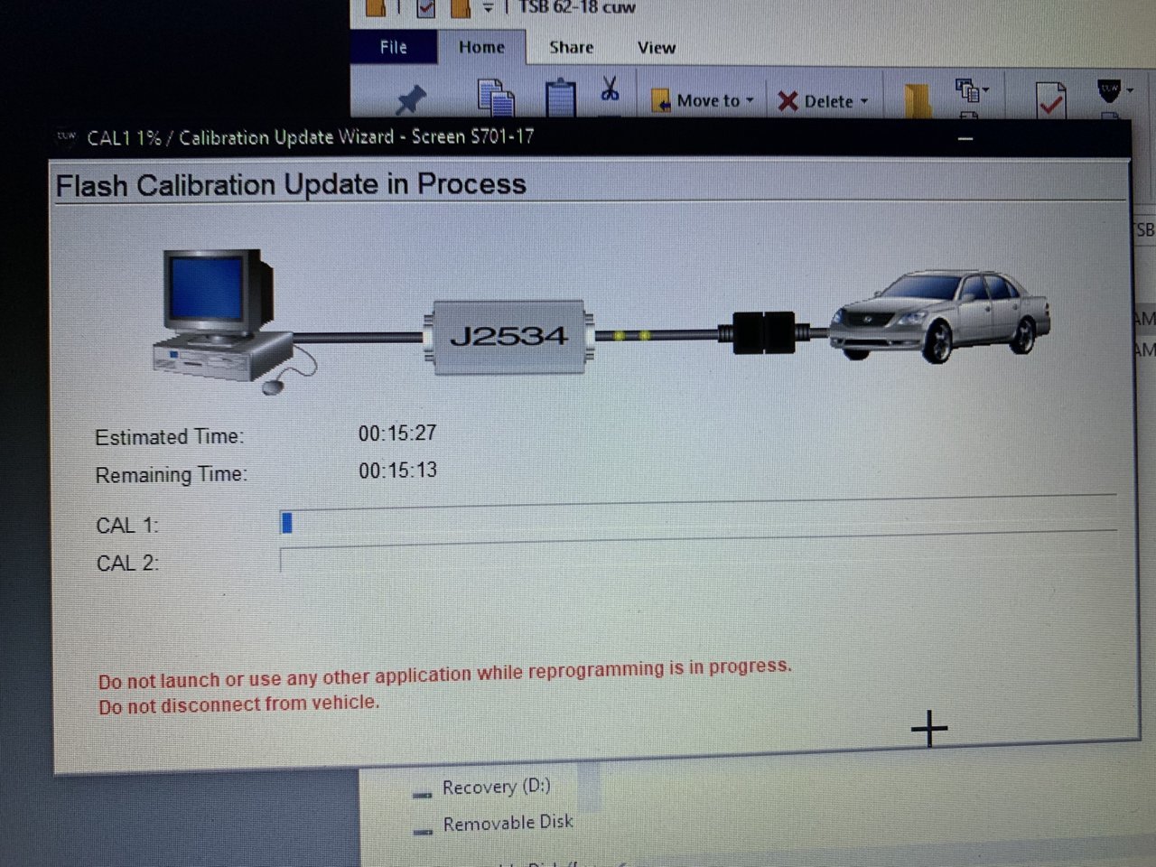

    That looks good...I don't see an error...you just need to wait at that point for it to finish....or is there an error message you didn't attach?

    Error message just said something like it failed and couldn’t continue. Then I tried again and it wouldnt connect.
    Tried to start the truck and it just cranked and cranked.
    I’ve flashed all versions of OVTune so im very familiar with the process. Laptop was isolated from internet and all running programs.

    Me personally...I'd try it again, but I'm a gamblin' man. The physical connection is VERY sensitive. I was flashing one time and bumped my laptop and it was enough to cause the flash to stop (this was OVtune, not Techstream, but they both use the same physical connection)...any chance you moved the laptop/cable while it was flashing?

    Steady as a rock. Only thing I’m thinking is that I didn’t start the truck prior to flashing to give the battery a charge. I’ve never done this before with OVTune and figured it was ok with Techstream.
    Going to try again with a trickle charge after a drive.
