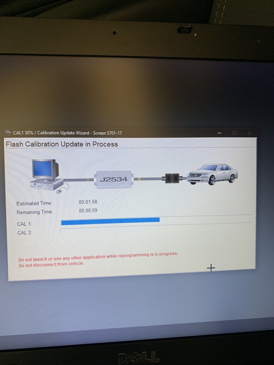

    TSB is going smooth this time. Ran the truck for 5 min prior to and have trickle charge connected

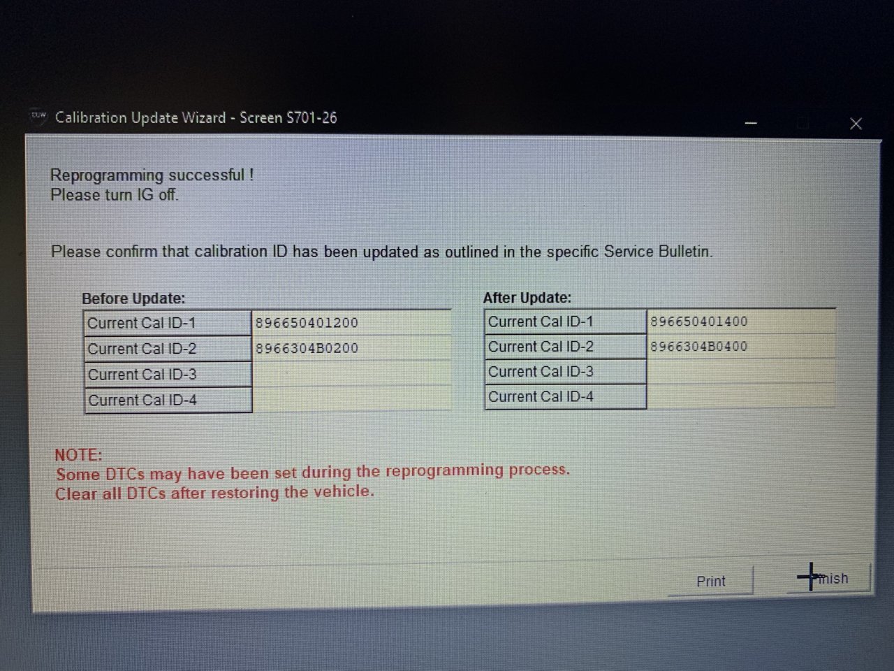

    A little info on my TSB flashing:
    1) did it first time first thing in morning. Didn’t work.
    2) truck kept cranking, no start.
    3) I have the tune with PCM flash, Matt said write stock tune.
    4) stock tune kept failing but I tried over and over, eventually worked.
    Truck ran fine and I was able to drive to work
    5) just tried again. Ran truck for 10 mins, trickle charge, TSB successfully installed
    dskakie and speedtre like this.
