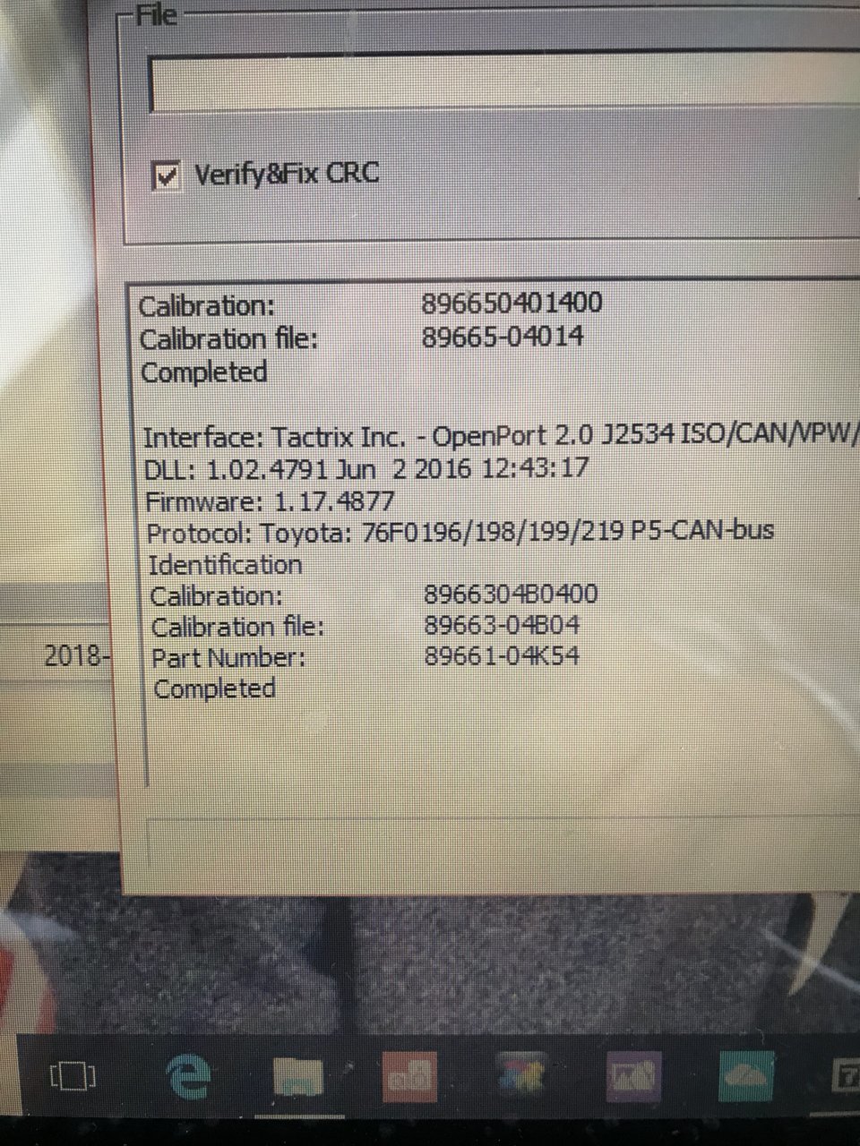

    @OVTune Just performed tsb 0062-18, new ID of 04B04. AT, dongle user. Any way I can’t test out 1.05 for you. I only have access to 91, but I’ve been running 1.04 91 for about 9k. Or can anyone hook a brother up with 1.04r 91 up?

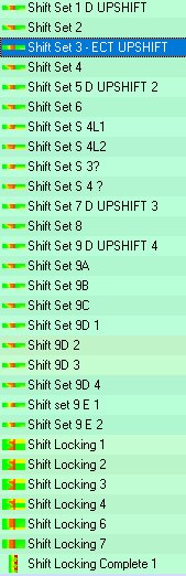

    An update on what we are working on finishing for 1.05 - (AT)
    and wanted to show why it can take so long. this isn't nearly everything, but some of what we are working on. Mapping each single shift point 1>2 , 2>3, 3>4, 4>5, 5> 6, 6>5, 5>4, 4>3, 3>2, 2>1
    4 different sets for D, ECT, Upshift, downshift, 4x4 and some others.
    I am also working on accelerator to throttle scaling per gear - , and finishing up the transmission shift torque expectation tables for smooth shifting.
    Once this is finished up, we are good to go.
    only posting the "vague" names of the tables on the board though
