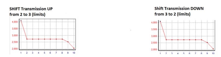

    OVTune
    OVTune [OP] Well-Known Member
    Mar 27, 2017
    #214557
    8,112
    OVTune
    It's the same image but used twice to represent two different things. The ECU has identical things for up and down in some situations but it is two separate tables.

  18. Nov 21, 2018 at 11:12 AM
    Lt_Dan
    Lt_Dan Well-Known Member
    Nov 12, 2015
    #169451
    455
    Daniel
    Cincinnati OH
    2017 TRD OR 4x4 DCSB A/T Super White
    It was strange to me that the curves were the same for UP and DOWN shifting, thanks for the clarification.
