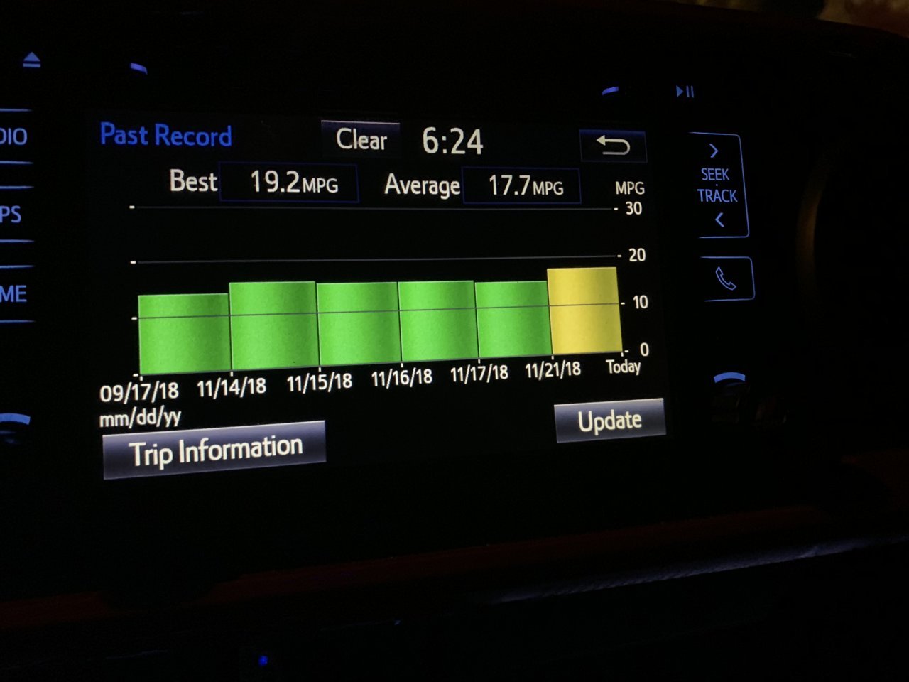

    Sorry to hear that about your MPG. It’s crazy how different one truck is to the next. I was just thinking yesterday that my MPG is getting better and better each tank. I’m on 35” with a 6” Suspension System. I started at 15-16 and yesterday I got 17.7
    However, I do agree. I hope 1.05 continues to increase our MPG. Interested to test out the 87 MPG vs the 92 Power. I wish I had access to 93 for the Total Performance option.
    honey and 20tacoma17 like this.
