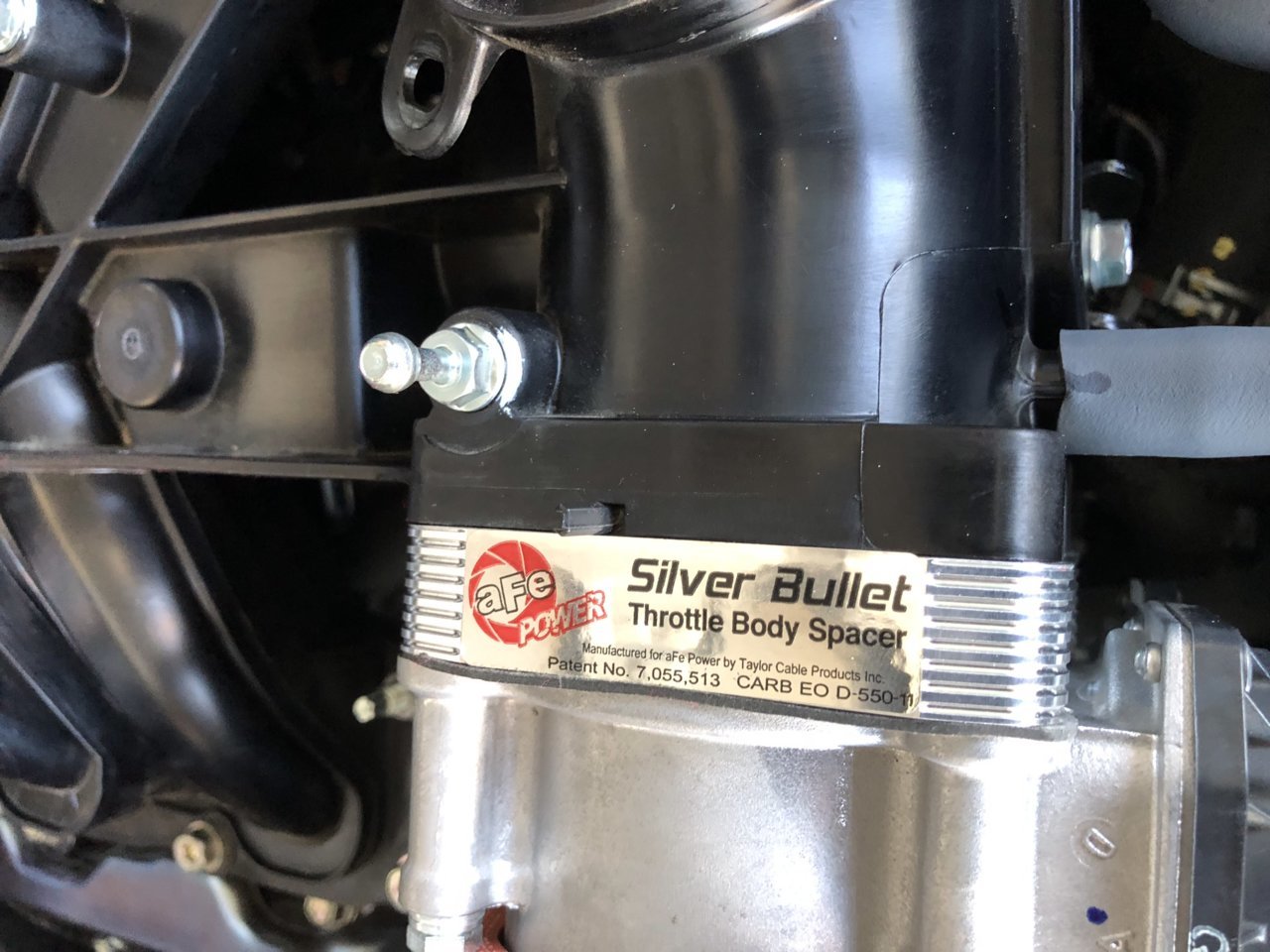

    Asked my mechanic about that. He said not enough to really matter.

    yeah this would make a tiny change at best and the fuel trims will correct for fuel errors up to 30% long 30% short. So the ECU has a lot of room to correct for fuel error.
    it has it's primary lambda targets and will do everything in it's power (fuel trims) to get those targets.

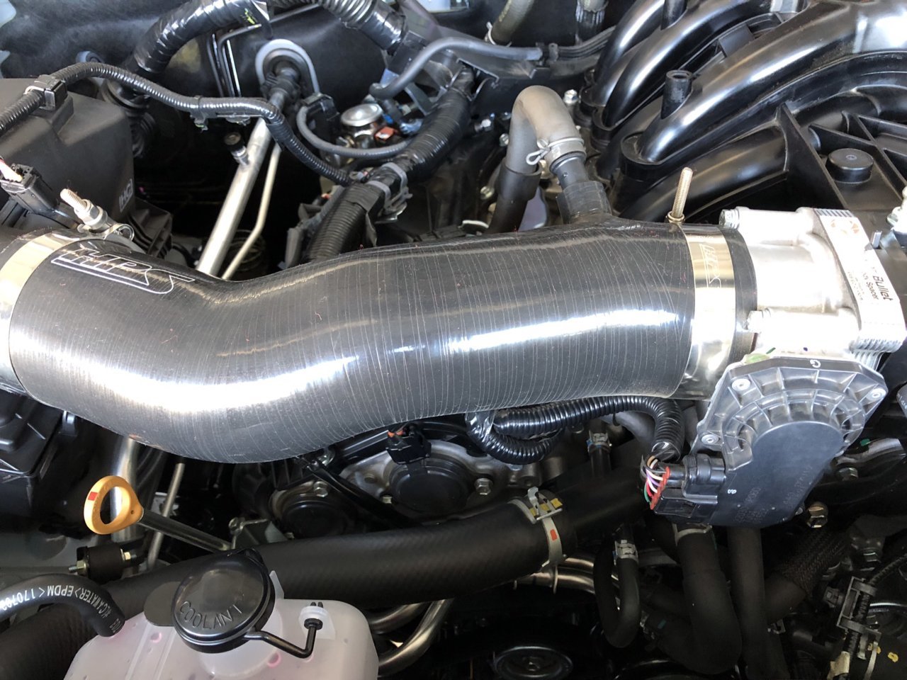

    Yes sir, you caught me Frank :thumbsup:
    Stock is a 65mm and tundra is 72 IIRC. I experienced minimal gains by itself but can also see where after I get my truck tuned to the TB it will be a different story. It's definitely an upgrade by itself but custom tuning is really necessary to get the most out of it

    I can assure you that that TBS is doing nothing
    Also, URD has sold the adapting plate for quite some time but I can’t find much info on it.
    https://www.urdusa.com/urd-throttle-body-adapter-76mm-for-2016-tacoma-with-3-5l-v6/
