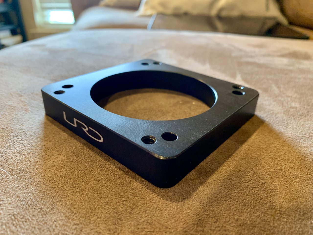

    Step 1 of getting my truck to breath better. BDD3C105-7B0F-4D9F-8674-539E0247B1D5.jpg

    curious to see end results and any difference.

    I won’t install it until a tune is developed

    Nice!
    Let's see the guts!

    What’s the end goal? 600 hp?
