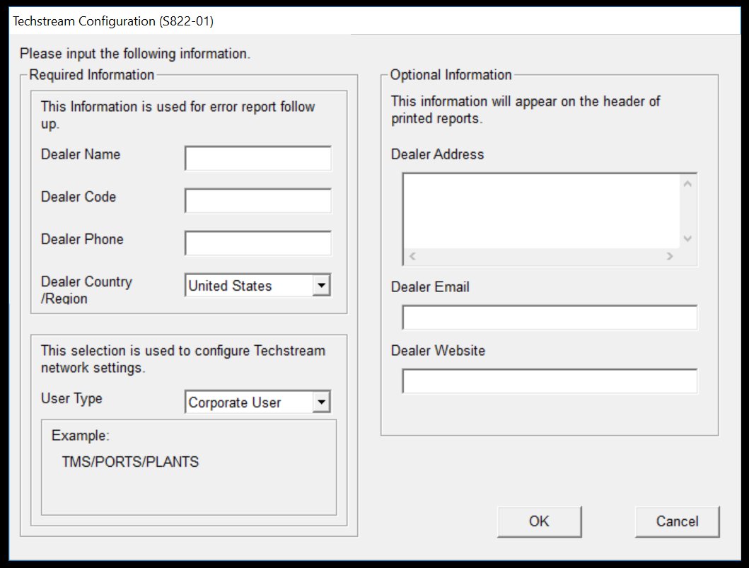

    So, I finally tried to download techstream today. I followed the instructions here http://blog.obdii365.com/2017/09/18/install-toyota-techstream-12-02-024-on-windows-7/ and I got to step 4 where you are supposed to "register techstream" and I get this screen where in the video it just opens right up. Any help would be appreciated.

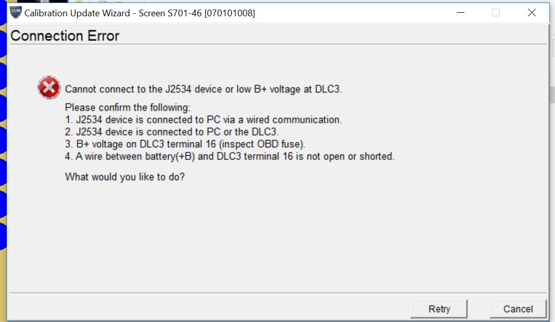

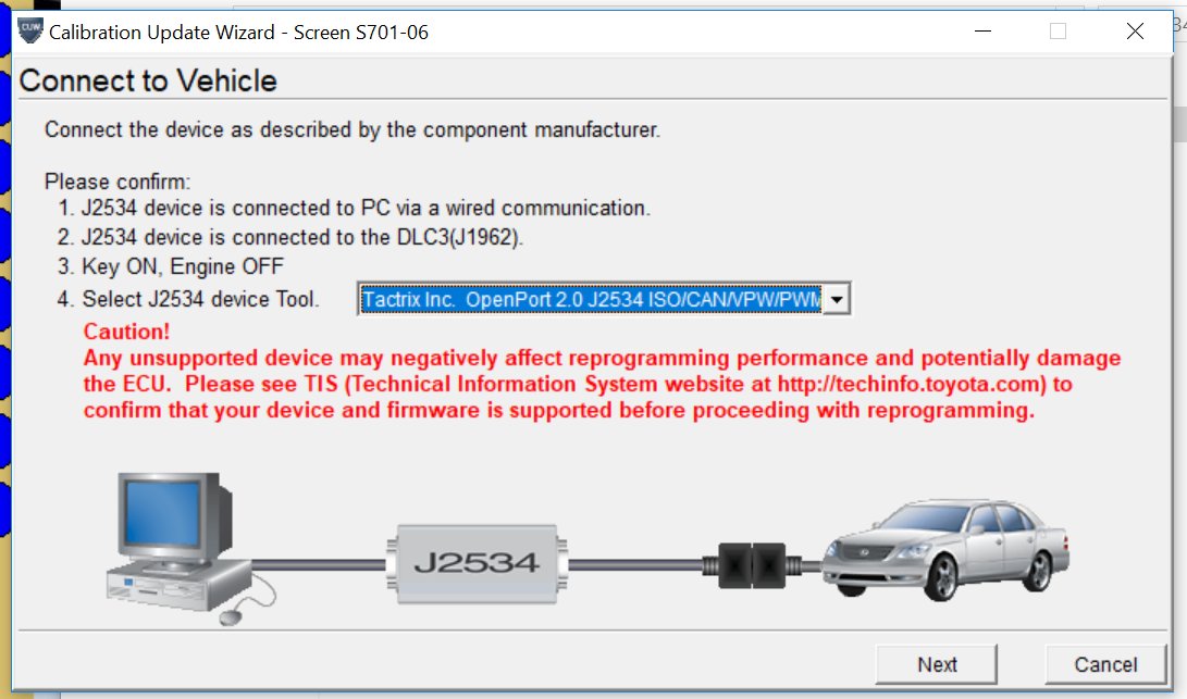

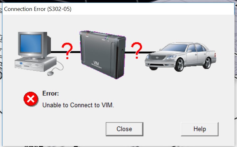

    Alright, I got past that screen. Now I just can't get the updater to populate. I install it, then can't find it anywhere on my computer.
    If I ignore that one, I get these errors.
    This is what I get when I hit "connect to vehicle" in techstream.
    This is what I get when I try to open the TSB to flash.

    Are you using the tactrix cable? There’s a drop down to change the interface to the tactrix adapter. Do that and you should be set.

    Yes, that was with the tactrix selected.
