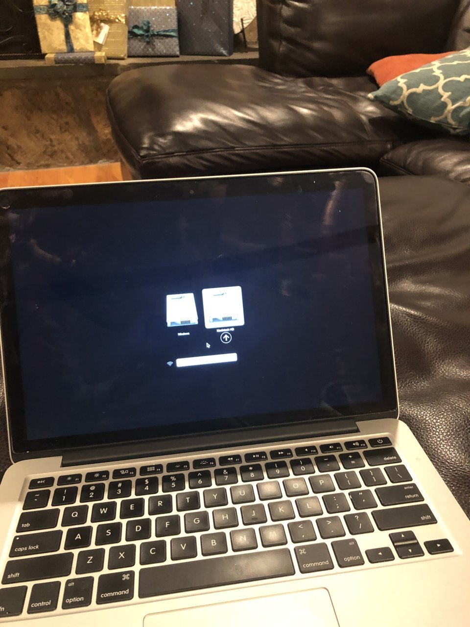

    OVTuned w/ 5.29s 2” lift on Dobinson’s MRR paired with ICON RXT leaf packs. SCS RAY 10s Toyo Open Country AT III 285/70R17
    Me too. Bootcamp on a Mac for the win!!!
    riz_atx[QUOTED] likes this.

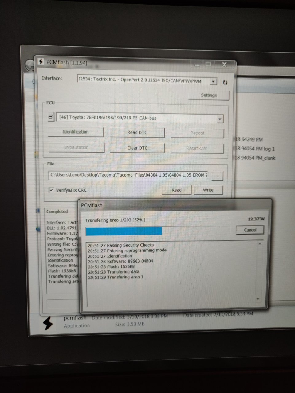

    I just flashed 105 91. The prompt said it was successful, but now the truck just turns over without starting. I’m repeating the process now. Any input?

    I think you have the correct process in place.

    I repeated the process with the same results. I’m now attempting to go back to 104r

    May need to flash to stock file and then back to 1.05 91. Not a normal procedure for everyone, but it has happened to another member years ago.

    I just went from1.04r to 1.05 93 - no issues. 10min idle in progress.

    Ok, I’m not sure what I’m doing differently. I tried
    i just tried to go back to 104r 91 with the same results. I haven’t tried stock. Maybe I’ll try that next.

    8,112
    OVTune
    Are you turning the truck off after the flash finishes

    And does he have a 04B04 ECU?

    Just flashed from 1.04R to 1.05, no issue. Truck started right up, idling now.

    Flash, after success, turn truck off, then start :)
