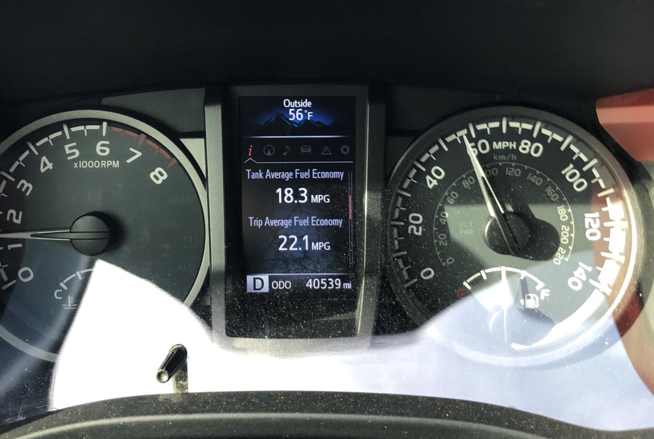

    1.05 91. Just got back from 160+ mile drive today for my job that consisted of a mix of surface street, highway and country roads both paved and dirt. Wow! Where to start. 1st thing, no idle issues for me. Truck is smooth at idle. Transmission shifting is smooth. Truck has stock gears on 33 inch Cooper ST Maxx 58 lb tires and I live at 6000 ft. I liked the 1.03 tip in with the bigger tires but it was a little touchy. 1.04r was a little soft but 1.05 feels great, easy to modulate. Power down low feels better and truck just feels more connected to each gear rather than downshifting at every tiny grade or hint of wind. Also the shifting is smooth.
    I actually saw 6th and 5th gear today on the highway but still needed 4th gear heading back west into a headwind doing 75-80 mph. (not expecting miracles with tall tires and tall gears). Without the headwind, truck easily held 6th and was much more relaxed on the highway. @OVTune has a winner here. Toyota North America should pay Mat for what he's done to fix their screw up. Will update OVTune Reviews page once I get a bit more time with it. Might throw my old stock wheels and tires on just to see how it feels on the highway.

    This was the initial trip mileage 30 miles mostly highway with truck using 6th and 5th gear and rarely downshifting to 4th. Actual number is higher since the computer is not accounting for the larger tire (+7%)

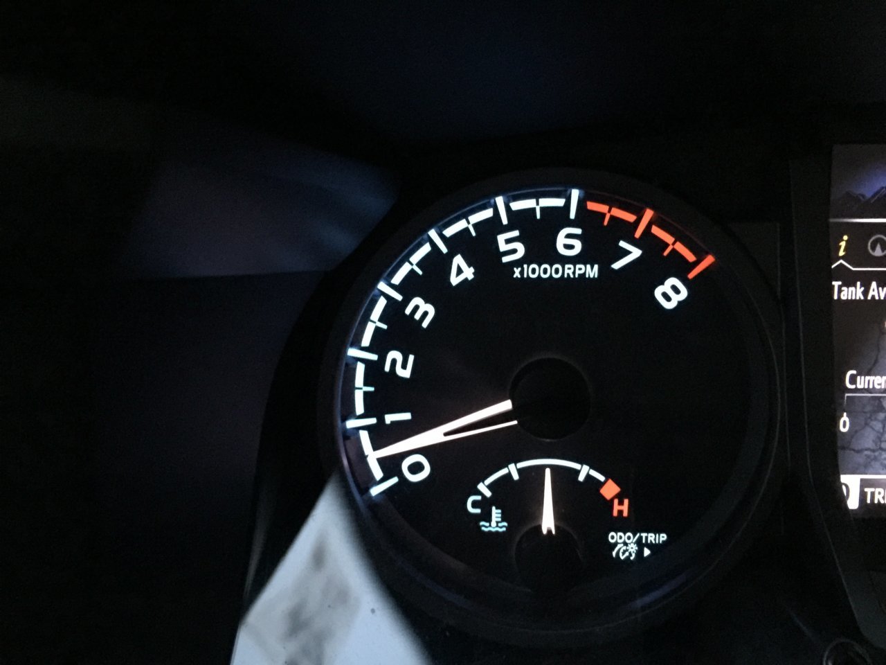

    Here is my idle, foot on brake in “D”

    Steady?

    Yep, doesn’t bounce at all
