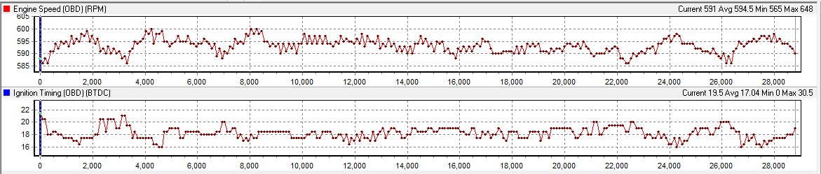

    Okay it looks like, for some trucks, the engine just needs a *tiny* bit more ignition at idle.
    Revision coming today.

    idle rock steady with +/- 15 rpm variance which is completely normal.
    Will send out to a few people to verify.
